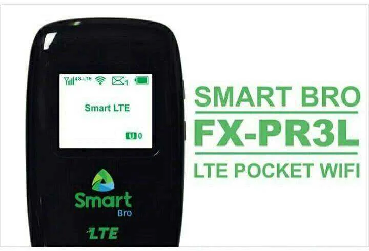

This is only for Smart Bro Pocket Wifi na Smart Evoluzn FX-PR3L LTE Pocket WiFi ang model. Try nyo din sa ibang smart pocket wifi kung gagana. See my screenshot.
So here's the tutorial:
1. Lagyan ng ibang sim like (Globe/TM)
2. Open your wifi then connect mo sa phone mo or pc.
3. Open browser then type this: 192.168.1.1
4. Login mo kung hinihingian ka password. Usually nyan ay "smartbro"
5. Go to Internet > MEP Settings
6. Input this unlocker code "@2N@t1Tr3"
7. Click unlock.
The router will restart then you're good to go.
Credits sa nag post nito sa facebook. Nakita ko lang.
Like lang sapat na. Feedback mga master.
