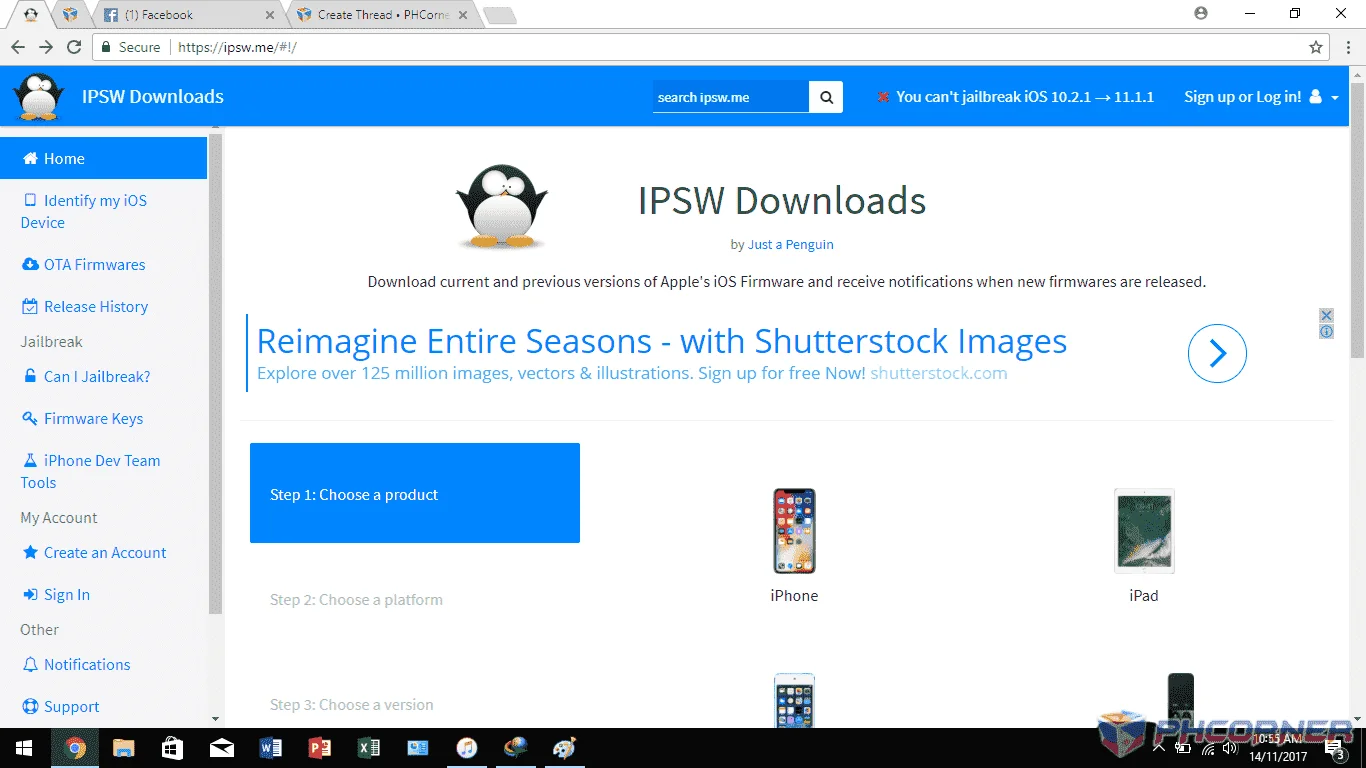

1. Go to You do not have permission to view the full content of this post. Log in or register now.

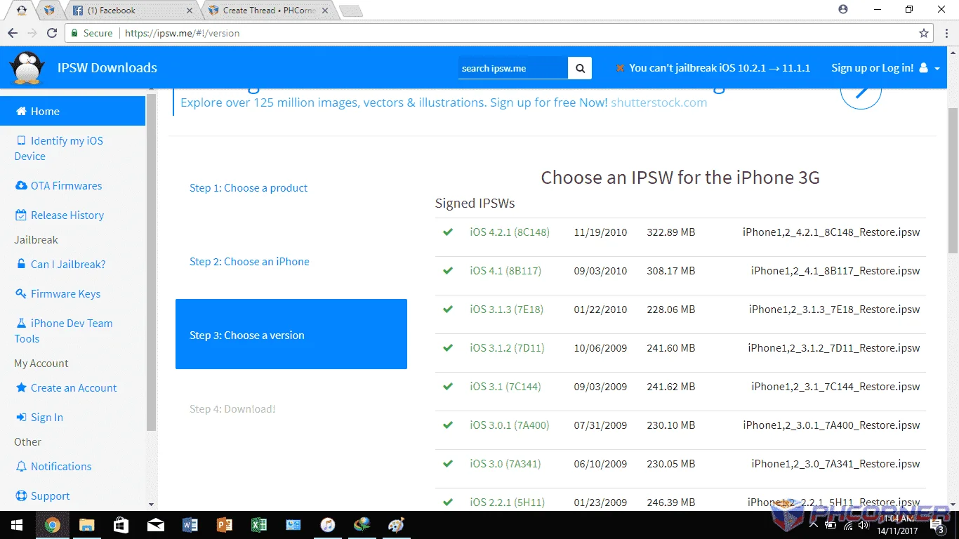

2. Then meron mga list ng mga apple devices sa website. Click mo if iPhone , iPad , or iPod ng device mo.

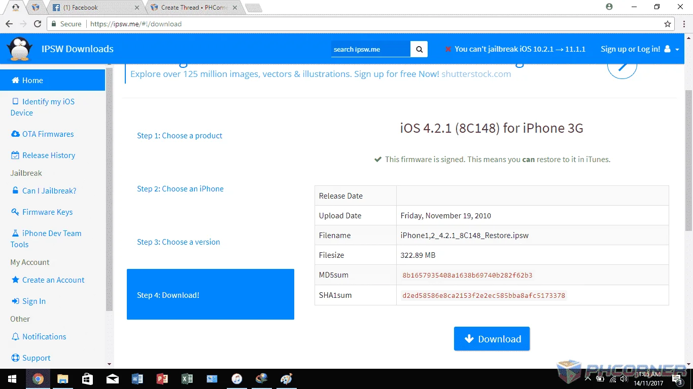

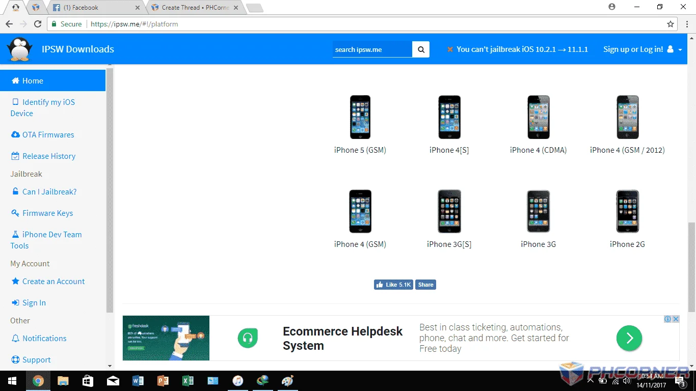

3. Select the proper device.
4. Select the green named firmware. (Note: Do not flash red named firmware. Hindi maging successful ng flashing. )
5. Click on download button and magoopen agad si IDM.

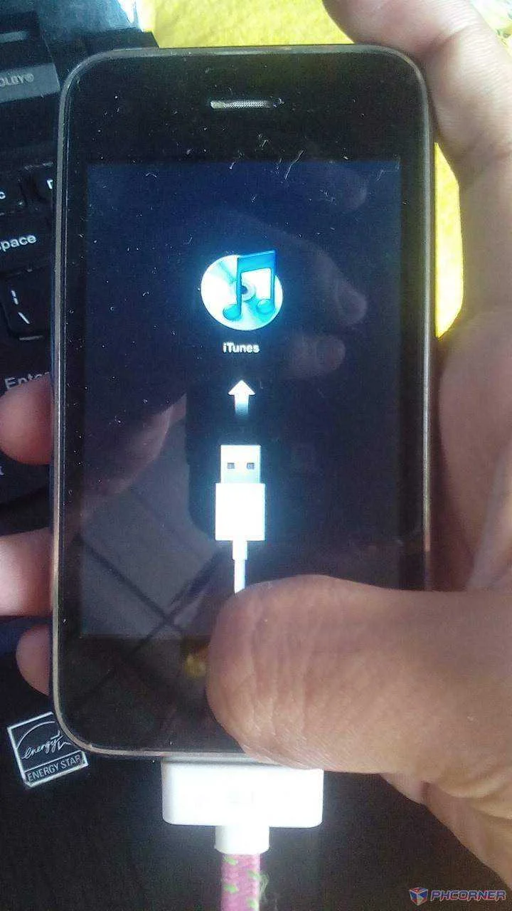

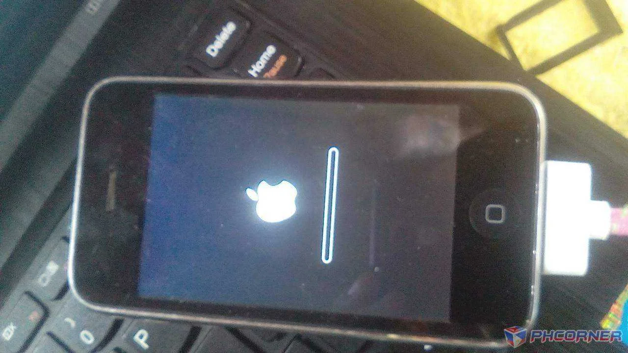

6. After mo matapos ng download , open mo si iTunes. Then sa iPhone hold home button while connecting usb cable. Until makita mo yung nasa picture.

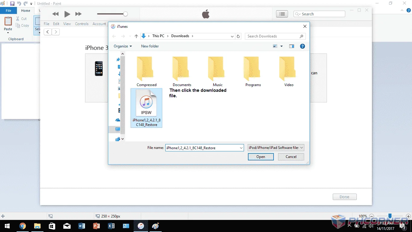

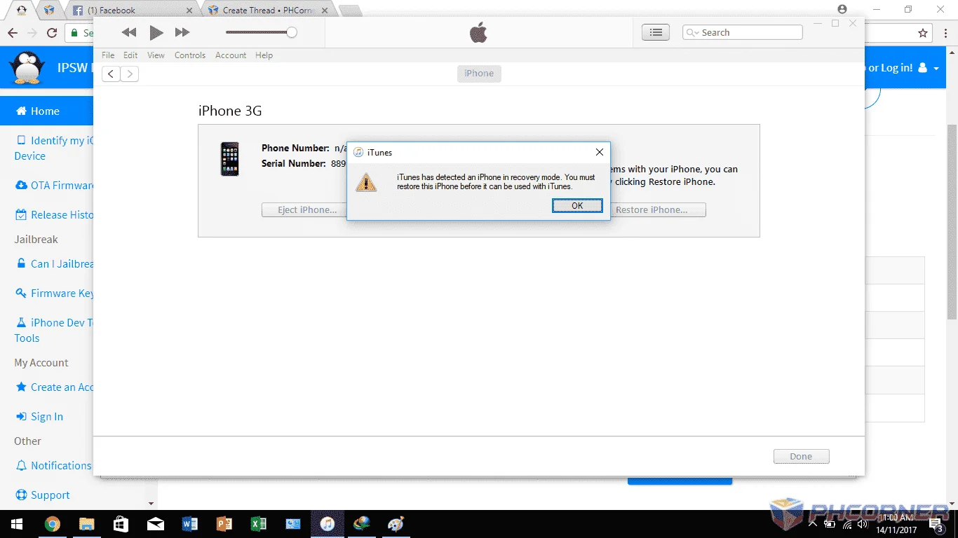

7. Then meron lalabas na warning. Click ok. Then follow the instructions kung panno iload ng file (.ipsw) sa iTunes.

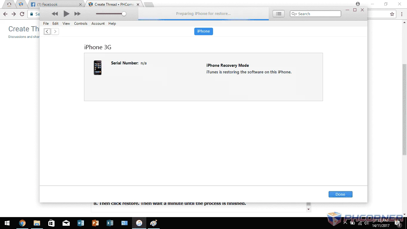

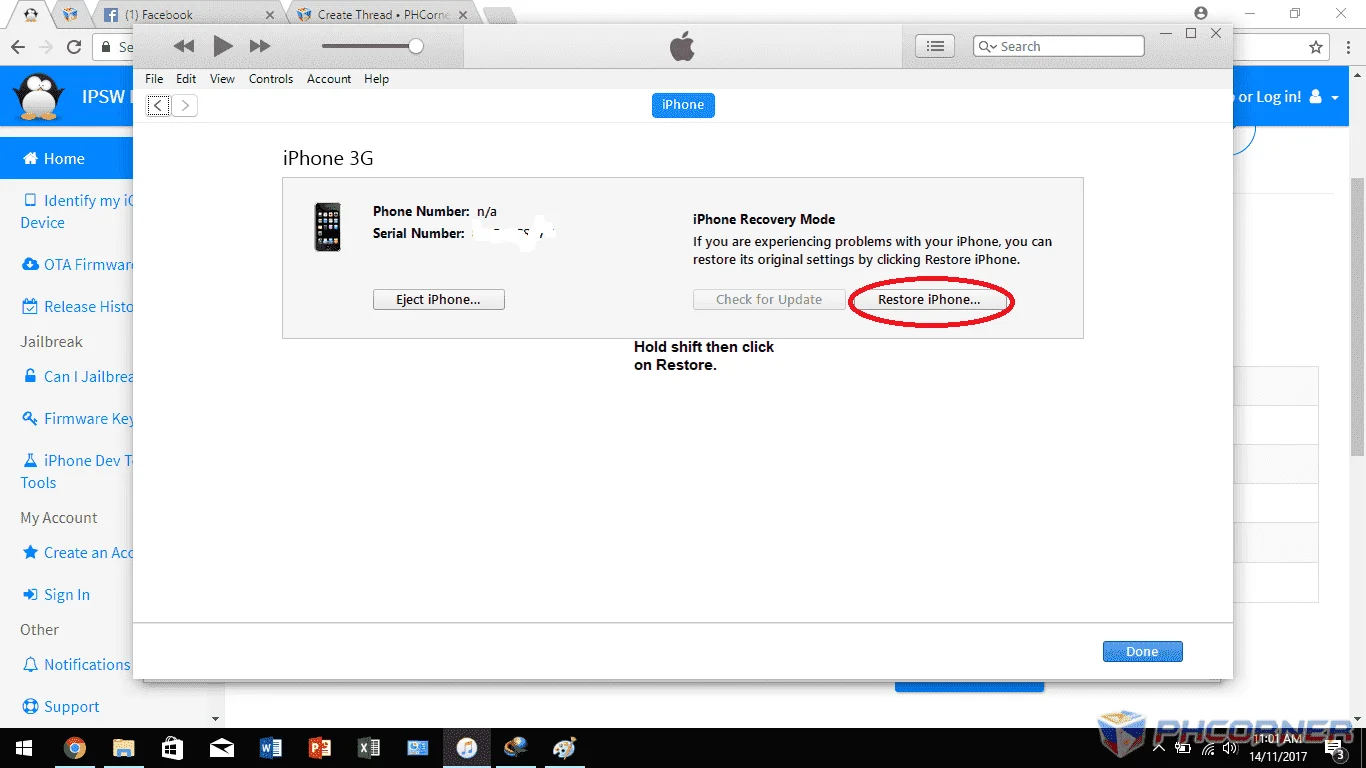

8. Then click restore. Then wait a minute until the process is finished.
9. After that complete the setup process and you're done!
