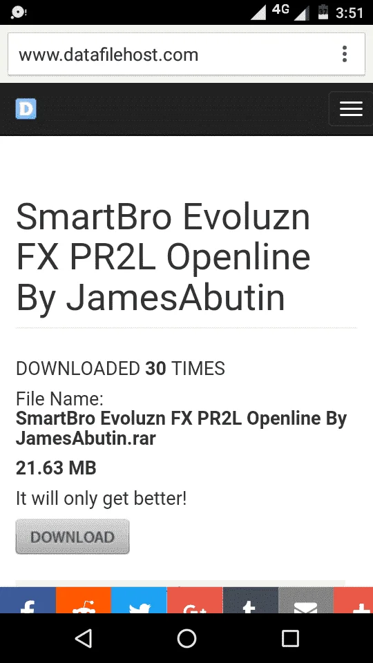

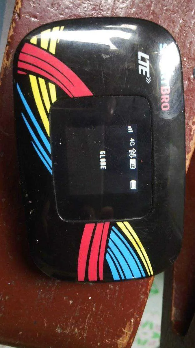

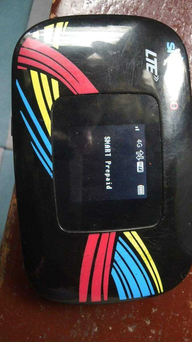

Openlined to Globe & Smart LTE. Kahit Thank you at Feedback lng ok na masaya nko!
Intruction:
  1. Download the tools and driver and your specified firmware (FX PR2 or FX PR2L).
  2. Extract the downloaded archives for later use.
  3. List down the IMEI, MAC and S/N which is written on the back of your device for later use.
  4. Run the SWDownloader.exe from the extracted firmware folder.
  5. Select the .blf file from the SWD folder in the extracted firmware folder.
  6. Make sure the erase all flash is ticked.
  7. Click the green bulb icon and connect your device using USB Cable with the battery removed.
  8. Wait until the flashing is done and disconnect it from the USB cable.
  9. Reboot your device and Connect.
  10. Access your dashboard by entering 192.168.1.1 in your browser and using "smartbro" credentials for username and password.
  11. Insert Globe SimCard.
  12. Go to MEP Settings and Enter 123456
For First Time Flasher you need to download this first to your computer.
Credit This Driver to sir Argotron.
SUCCESS !
FX PR2L Openlined Firmware by JamesAbutin - You do not have permission to view the full content of this post. Log in or register now.
FX PR2 Openlined Firmware by James Abutin - You do not have permission to view the full content of this post. Log in or register now.
