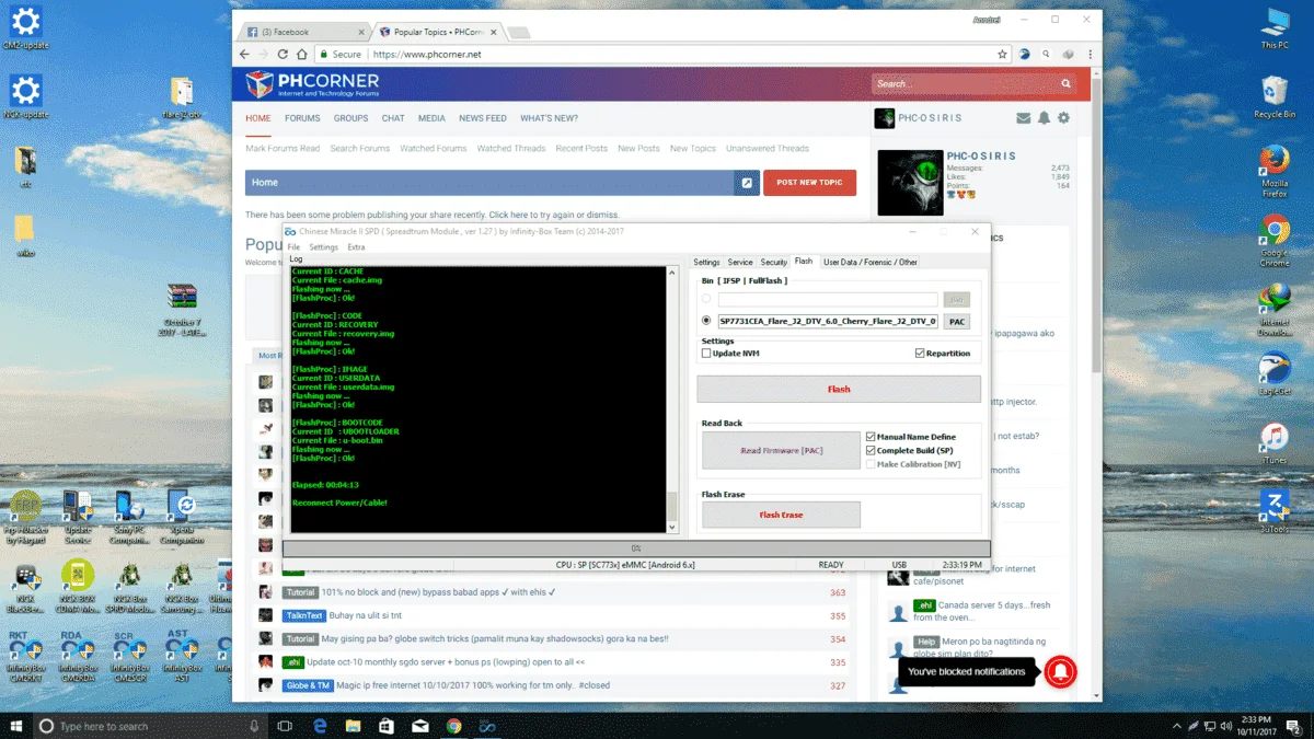

Problem: Hang logo
Solution: Flashing

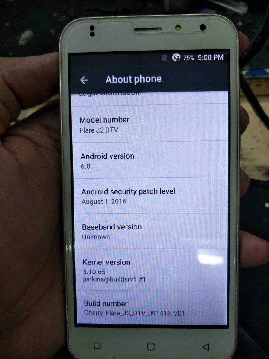

Phone info:
Reading extended info ...
Model Name : pike_xx08
Model Brand : cherry_mobile
Model Device: Flare_J2_DTV
AndrVersion : 6.0
BaseBand CPU: SP7731CEA
CompileDate : 9/14/2016 11:20:31 AM
Project Ver : Cherry_Flare_J2_DTV_091416_V01
Model Ext : Flare_J2_DTV

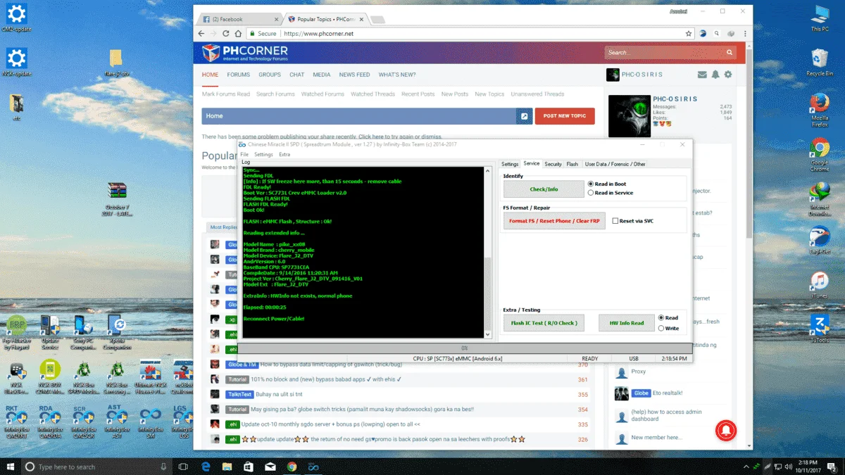

Flashing:
Phone found! [ 5 ]
Port Opened
Sync...
InitBoot Done [ 0x81 ] , Ver : SPRD3
Sync...
Sending FDL
[Info] : If SW freeze here more, than 15 seconds - remove cable
PickUp loaders from pac
FDL Ready!
Boot Ver : Spreadtrum Boot Block version 1.1
Sending FLASH FDL
FLASH FDL Ready!
Boot Ok!
FlashMode Set : Ok!
PMTManager : Load 0x19 records
PMTManager : PMT Update Ok!

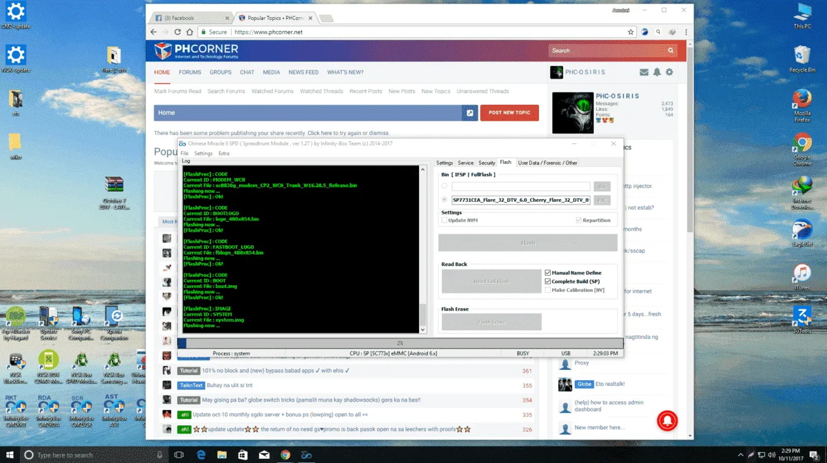

Flashing now
[FlashProc] : CODE
Current ID : PRODNV
Current File : prodnv.img
Flashing now ...
[FlashProc] : Ok!
[FlashProc] : ERASE
Current ID : ERASEUBOOT
Current Part : uboot
[FlashProc] : Ok!
[FlashProc] : ERASE
Current ID : FLASH
Current Part : wruntimenv1
[FlashProc] : Ok!
[FlashProc] : ERASE
Current ID : FLASH_WCN
Current Part : wcnruntimenv1
[FlashProc] : Ok!
[FlashProc] : ERASE
Current ID : ERASEMISC
Current Part : misc
[FlashProc] : Ok!
[FlashProc] : BOOTCODE
Current ID : SPLLOADER
Current File : u-boot-spl-16k.bin
Flashing now ...
[FlashProc] : Ok!
[FlashProc] : CODE
Current ID : MODEM_W
Current File : sc7731C_CP0_modem.bin
Flashing now ...
[FlashProc] : Ok!
[FlashProc] : CODE
Current ID : DSP_W
Current File : DSP_DM_Gx.bin
Flashing now ...
[FlashProc] : Ok!
[FlashProc] : CODE
Current ID : MODEM_WCN
Current File : sc8830g_modem_CP2_WCN_Trunk_W16.28.5_Release.bin
Flashing now ...
[FlashProc] : Ok!
[FlashProc] : CODE
Current ID : BOOTLOGO
Current File : logo_480x854.bin
Flashing now ...
[FlashProc] : Ok!
[FlashProc] : CODE
Current ID : FASTBOOT_LOGO
Current File : fblogo_480x854.bin
Flashing now ...
[FlashProc] : Ok!
[FlashProc] : CODE
Current ID : BOOT
Current File : boot.img
Flashing now ...
[FlashProc] : Ok!
[FlashProc] : IMAGE
Current ID : SYSTEM
Current File : system.img
Flashing now ...
[FlashProc] : Ok!
[FlashProc] : CODE
Current ID : SYSINFO
Current File : sysinfo.img
Flashing now ...
[FlashProc] : Ok!
[FlashProc] : IMAGE
Current ID : CACHE
Current File : cache.img
Flashing now ...
[FlashProc] : Ok!
[FlashProc] : CODE
Current ID : RECOVERY
Current File : recovery.img
Flashing now ...
[FlashProc] : Ok!
[FlashProc] : IMAGE
Current ID : USERDATA
Current File : userdata.img
Flashing now ...
[FlashProc] : Ok!
Current ID : UBOOTLOADER
Current File : u-boot.bin
Flashing now ...
[FlashProc] : Ok!
Elapsed: 00:04:13
Reconnect Power/Cable!

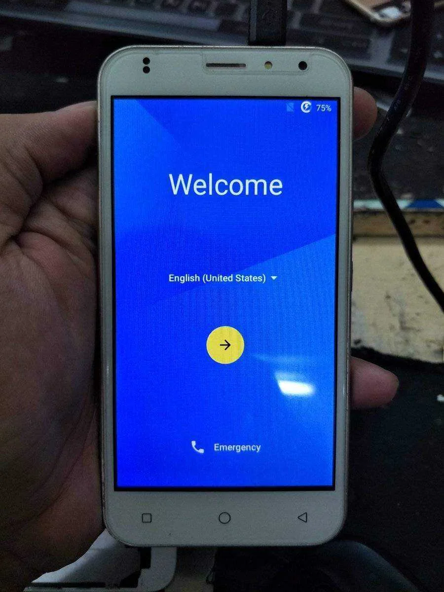

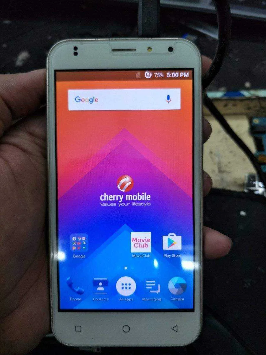

Phone Screenshots:
fimware here
Note: pag na encounter niyo yung pag natapos na ang flash tapos nag boot up na unit try niyo ipower off pag nag stock sa logo flash niyo ulit tapos hard reset para dina maulit yung hang.
