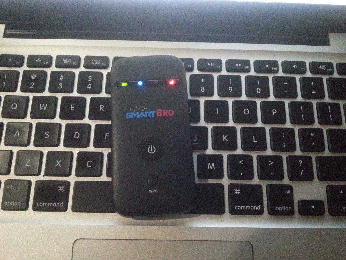

🔒 Closed Pansinin nyo naman ako, please. i need help with my smartbro.
Dapat po walang nakaindicate na X mark para makapagbrowse ka na. Try mo ulit ireboot pocket wifi mo for the last time madam.

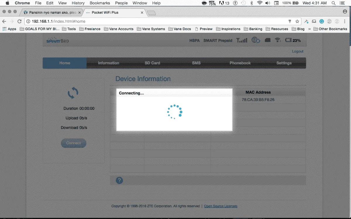

Ganito po lumabas, after reboot.
MGA FEW SECONDS SYA NAKA RED, THEN NUNG NAG GREEN.
IT TOOK FEW MINUTES PO BAGO MAG CONNECT.

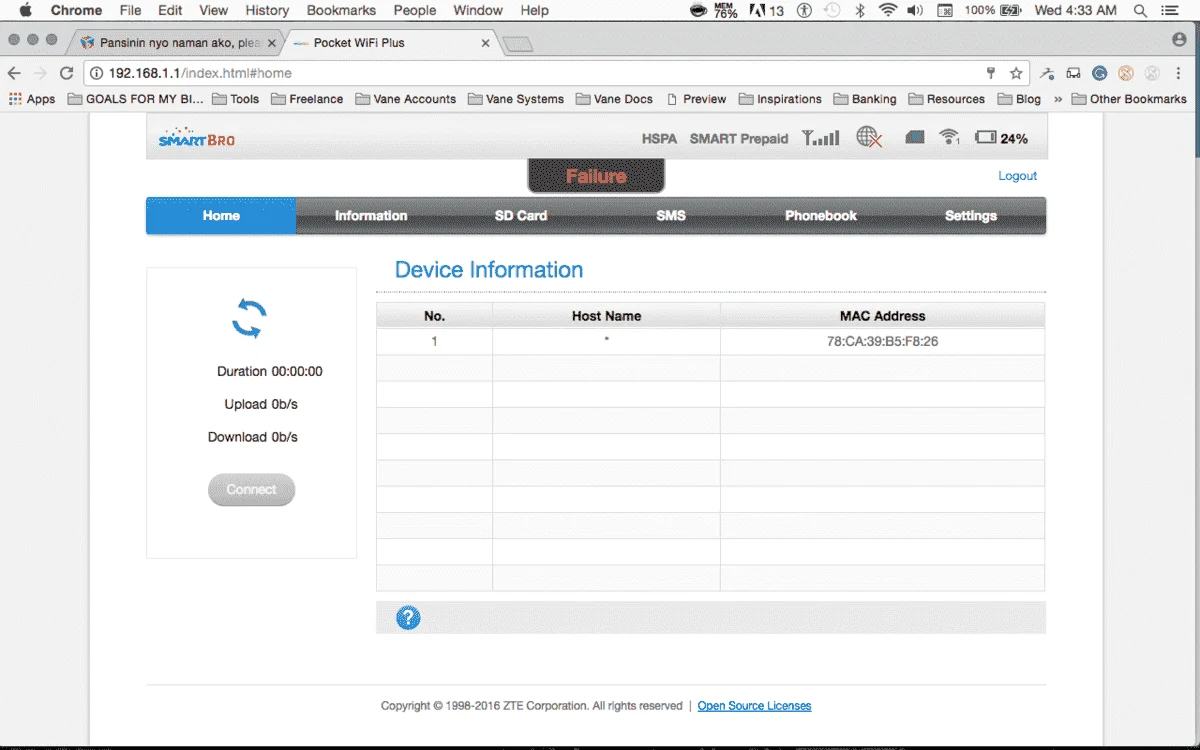

THEN, ITO NA PO.. "FAILURE" NAKALAGAY.

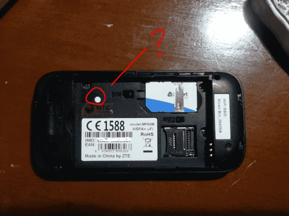

May last option pa po. Try mo ihard reset using a pin or needle. (kung meron man). That button is commonly located at the battery section. Pag wala mas maiging dalhin mo na po sa technician na pinagbilhan for a possible repair or papalitan kung may warranty seal yan.
Apologies po if super noob ko, pero ito po ba yun?
maam e try mo e insert sa phone mo ang sim tapos dial ka *#*#4636#*#* tapos may naka lagay dun na phone settings click mo tapos hanapin mo wcdma preferred e click mo tapos click mo ang wcdma only tapos direct mo po e off cp mo at tangalin ang sim tapos e insert sa pocket wifi. kapag po gumana good to you kapag hindi pasensya po . so good luck po
