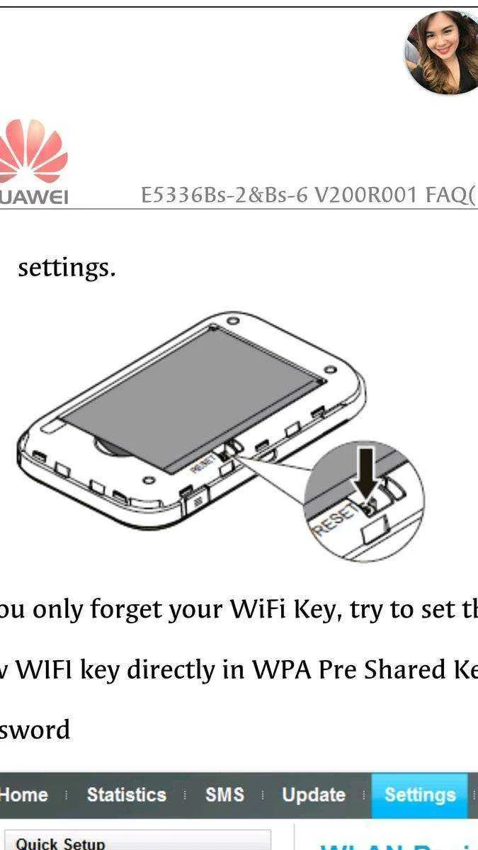

Try this, nahanap ko sa google
Oo marereset lahat yan. Admin password, ssid at wifi password,
Reset Button
Press and hold the RESET button until the display screen turns off. The E5336Bs-2&Bs-6 is then restored to its factory settings.
Dapat pala naka on tapos pindutin mo reset button
