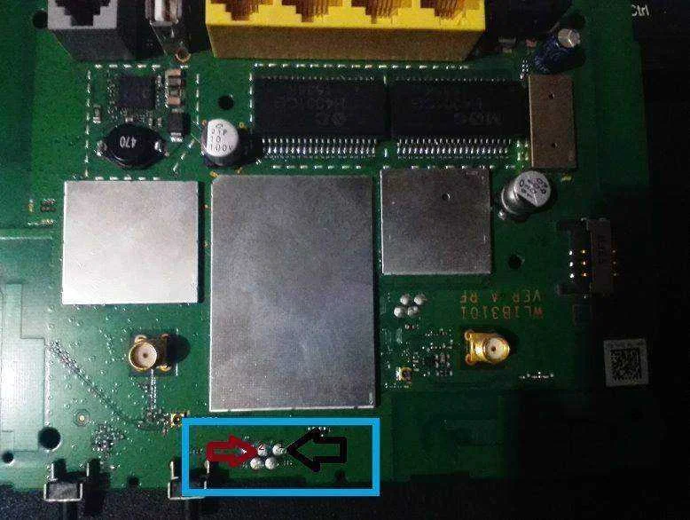

Una sa lahat hindi akin to. Dami kasi nagppm bumabalik sa powerled mag flash new firmware. Credits sa mga may ari neto. Pinulot ko lang to kung saan saan
Pwede na din mag change any firmware via web gui (local update). Nasa ibang post ko ang mga firmwares.
Download needed files here:
:) You do not have permission to view the full content of this post. Log in or register now. :)You do not have permission to view the full content of this post. Log in or register now.
Steps:
1. Jumper - ground two points. Dapat walang iilaw sa modem kahit isa. Refer to the pic below :)
2. Plug USB to USB cable. May ma detect na 3G PC UI Interface
3. Open files. Run
commitblocks.cmd then select option number 1 (Ok)
4. Turn off Modem then do the Jumper - ground two points
5 Open files. Run
load_usbdloader.cmd. Tingnan ko na detect ang port
6. Open files. Run
B315s-22_Update_21.311.05.00.00_M_01.01_nvr.exe
7. Once done na flashing. Hintayin lang mag reboot at tanggalin usb to usb cable at power.
8. Saksak adaptor ulit.
9. Success flashing. Buhay na.
10. Update firmwares like 21.321 and 21.315 thru local update. Update menu -> Local Update | Update -> Local update.
Para sa mga firmwares. Dito ang thread: https://phcorner.org/t/b315s-936-evo-polko-latest-at-added-2100mhz-pwede.350495/
Credits to those who made these tools/files/ideas. 4pda.ru
