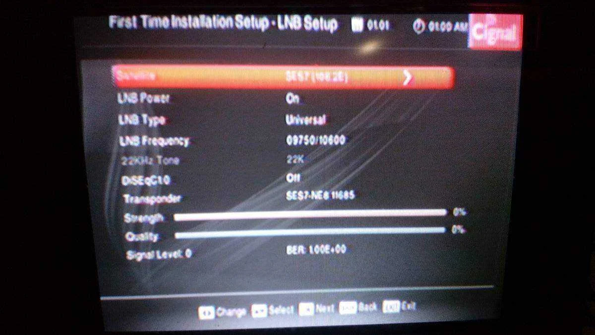

Pa help po pls..na reset ko kasi cignal tv box namin.tapus after nun wala nang mga channel.tapus na stuck po sa FIRST TIME INSTALLATION SET UP - LNB SET UP..
Eto po LnB setup ko default, Cignal Prepaid HD box.
Satellite: SES 7 (108.2E)
Lnb power: On
Lnb Type: universal
Lnb freq: 09750/10600
DiSEqC1.0: off
Transponder: SES7-NE7 11655
Pero ang alam ko lng kasi magkakaiba transponder every channel eh tapos mo input yan magsearch ka channel kung meron hehe
Channel 1 po kasi agad agad yan pagkaopen diba pag nainput mo na yung sa lnb etc. try mo magseach ng channel dapat ok na yung channel 1 pero pag ayaw po talaga call ka CS ni cignal
panu e save?kasi pg exit ko my lumalabas na e save ko daw.tapus pg ok ko.pg in off ko ulit tapus pg open balik na naman sa LNB set up.

..hmm..restore po tas search channel ..sa pagaalign po..try nyo 70 degree tas ikot nyo ang dish hanggang mkahanap ng signal..
Note po bago po nyo irestore dapat ng my signal strength at quality..
Sorry to highjack this thread. Ganon din ang nangyari sakin. Factory reset ko kaso wala ng channel after factory reset pero malakas naman ang signal. Paano ba mag channel search?
Same problem with her po, Na'factory reset q dn po yung Cignal namin and we moved the dish na po kso no progress po. Zero lahat ng strength, quality tas Signal Level
