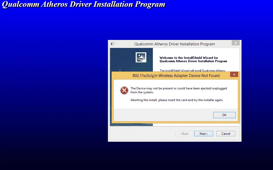

๐Ÿ”’ Closed Pahelp po..bigla na lng nawala wifi ng laptop ko. di mainstall ang driver.
format nga po yan kasi wag gagamit ng driver pack nakakaksira ng pc o laptop yan
may windows update naman at brand driver tools naman kada laptop ha kung msi hp samsung may driver tools yan para di ka magkamali sa version ng driver na ginagamit mo
ganyan din ako dati gusto ko latest version lagi yung mga driver ko kaya laging nasisira yung os kasi kung anu anu iniinstall kong driver
Maybe you are trying to install a software of a hardware that doesn't "exist" in your laptop. Check the names properly if identical. Better yet uninstall your current software/driver of your WiFi adapter and just let windows update itself.
Another best solution is to go back to an earlier time via a restore point.
If all doesn't work maski reformat then hardware is the problem. Consult a technician.
check mo s FN button bka nk-off wifi or try to connect lan cable then update driver online.. Device Manager k tpos hanapin mo ung Wifi Driver then search online driver
nag update ka ba ng bios? meron kasi akung na eencounter na ganyan mostly toshiba brand na laptop after magupdate ng bios di na madetect wifi module. or pwede rin mismo yong wifi module ang mai problema. or pwede rin na naoff mo lang yong wifi tignan mo sa keyboard mo or sa sides ng laptop mo meron yan on off
