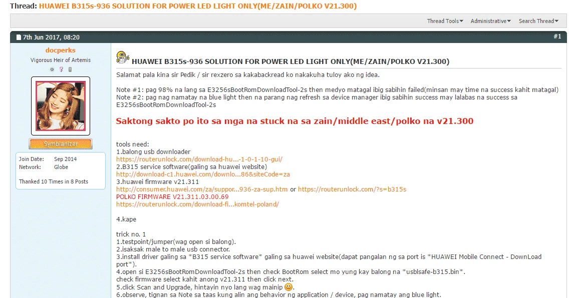

Note #1: pag 98% na lang sa E3256sBootRomDownloadTool-2s then medyo matagal ibig sabihin failed(minsan may time na success kahit matagal)
Note #2: pag nag namatay na blue light then na parang nag refresh sa device manager ibig sabihin success may lalabas na success sa E3256sBootRomDownloadTool-2s
Saktong sakto po ito sa mga na stuck na sa zain/middle east/polko na v21.300
tools need:
1.balong usb downloader
2.B315 service software(galing sa huawei website)
3.huawei firmware v21.311
You do not have permission to view the full content of this post. Log in or register now. or You do not have permission to view the full content of this post. Log in or register now.
POLKO FIRMWARE V21.311.03.00.69
4.kape
trick no. 1
1.testpoint/jumper(wag open si balong).
2.isaksak male to male usb connector.
3.install driver galing sa *B315 service software* galing sa huawei website(dapat pangalan ng sa port is *HUAWEI Mobile Connect - DownLoad port*).
4.open si E3256sBootRomDownloadTool-2s then check BootRom select mo yung kay balong na *usblsafe-b315.bin*.
check firmware select kahit anong v21.311 then click next.
5.click Scan and Upgrade, hintayin nyo lang wag mainip smile.png.
6.observe, tignan sa Note sa taas kung alin ang behavior ng application / device, pag namatay ang blue light.
7.alisin ang male to male usb connector at power adaptor.
8.saksak power adaptor, pag nag blink lang yung power led light punta ka sa trick no.2
trick no. 2
1.testpoint/jumper.
4.open balong usb downloader load mo yung *usbloader.bin* kasama ng E3256sBootRomDownloadTool-2s(mapapansin nyo nag load pero di na detect sa PC)
5.alisin ang male to male usb connector pati power then testpoint/jumper ulit
6.open si E3256sBootRomDownloadTool-2s then check BootRom select mo yung kay balong na *usblsafe-b315.bin*.
7.click Scan and Upgrade, hintayin nyo lang wag mainip smile.png.
8.observe, tignan sa Note sa taas kung alin ang behavior ng application / device, pag namatay ang blue light.
9.alisin ang male to male usb connector at power adaptor.
10.saksak power adaptor
mukha repost no sir. galing sa kabila yan sa thread ko wala pa ko nakita ganyan na method kaya pinost ko na din dito. gusto ko lang makatulong.
Thanks for this thread. Yung modem ko kasi stock sa Middle East Firmware, ilang araw din ako naghanap ng solution para maibalik ko sa dating Polkomtel. Sa una, hindi ako nagkaigi pero nagawa ko rin maibalik sa Polkomtel Firmware. Thanks po.
