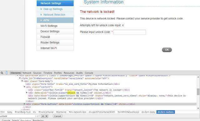

STEP 5. Press F12 or Ctrl + Shift + i
STEP 6. Press Ctrl + F then find keyword Unlock

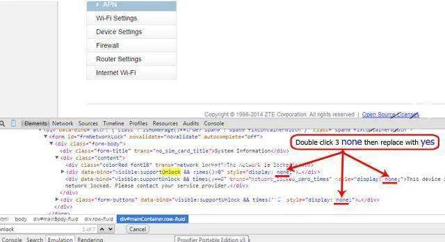

STEP 7. To Reveal unlock dialog box, simply double click 3 none then replace with yes
( see picture below ) double click to enlarge the pictures.
LAST STEP 8. Enter 16 digit unlock code then press ENTER Done!

boss bakit sakin kahit di gamitin ung usb.. same procedure na access ko yan.. 5 attempt naka lagay.. salamat.. para saan pala ung sd card slot?
