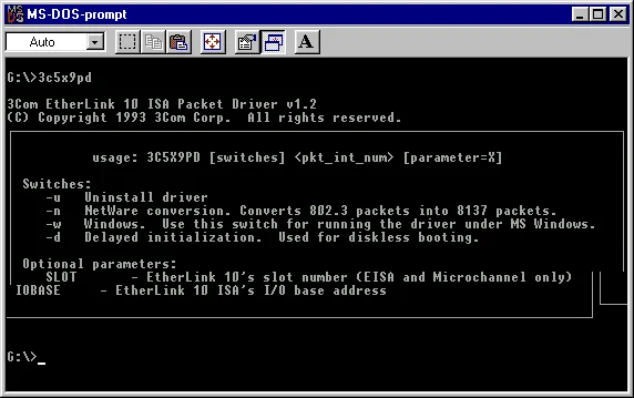

Assuming a PC with MS-DOS v.6, with a 3COM EtherLink III 3c509B ethernet card.
First of all we need a Packet Driver for this card. It's called 3C5x9PD.COM, so it's executable and can be run from the command prompt or a batch file.
Apparently, we need to supply an interrupt vector, <pkt_int_num>, a software interrupt that other applications can use to find the location of the driver in the computer's memory, and use it to get their bits and bytes through the network adaptor on to the network. . These packet drivers usually get interrupt vectors 0x60,0x61,0x62, etc.
Note that the card itself has interrupt 10. This is the hardware interrupt of the network adapter, used by the network card to 'get the attention' of the CPU. It can (sometimes / usually) be modified either by jumper settings on the card itself, either with a configuration tool if that came with your NIC, either it's Plug and Play - but no P&P under DOS !
More hardware stuff : I/O base address (can be changed with the option 'parameter' as shown on the screen - in case it conflicts with other devices). This is the I/O address where the CPU can communicate with the NIC. Ethernet Address : Unique address, 'build into' the circuits of the network interface card. (a.k.a. MAC address). used to identify the device, and the computer where it is located, within the ethernet network. If you're on a network with Dynamic Host Configuration (dynamic IP addresses !), The DHCP server will associate an IP address to this MAC address.

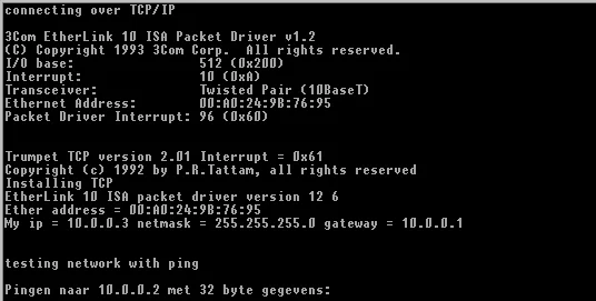

The executable for Trumpet's DOS TCP/IP stack is tcpdrv.exe. You can supply all your network parameters (ip address, netmask, ...) as command line options. (there's a link to the readme file further down). You can also make environment variables to hold these values, and tcpdrv will read them and use them.
tcpdrv.exe will also look for a packet driver, and if you have installed one, it will find it and use it.
So a very simple way to provide TCP/IP connectivity to a DOS pc would be to collect all the software mentioned, put these files in a directory, and create a batch file to

This batch file can now be seen both as a command to get your PC on the LAN over TCP, and as a configuration file (edit the batch file to change network parameters). When it's run, you clearly see how the packet driver is loaded, then how TCP is installed taking the network parameters you've entered.
This seems to work - piece of cake. But I haven't tested this - the other PC, the one I should connect to, is temporary out of order due to a hard disk crash, ... But it looks as if it might work, doesn't it ?

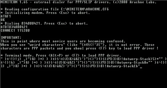

The following example uses dospppd for the ppp layer, and miniterm as dialer. miniterm is the dialer used by Arachne (copyright Arachne Labs). Miniterm uses arachne.cfg as configuration file.To dial a modem, the file may look like this :
[dialer]
Dialer @MINITERM.EXE>PPP.LOG
UseTerminal Yes
Port 1
Irq 4
Base 0x3f8
Mode 8N1
Speed 115200
InitString AT&F1
DialString ATDT
PhoneNumber 034004321
Autologin No
PPPusername johnyBgoode
PPPpassword 123456

This is what it looks like on screen
