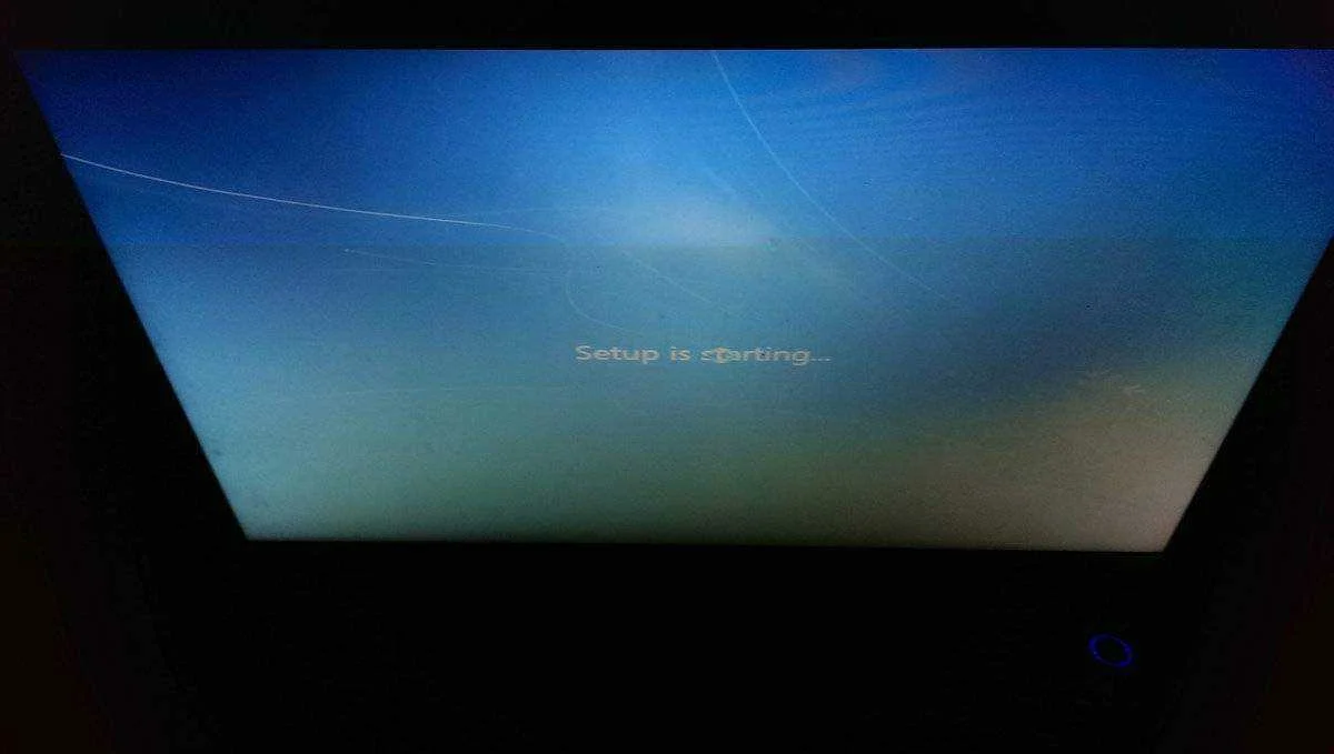

startup problem,ginamit ko yung installation disc para erepair ayaw pa rin,reformat ko na lang.umabot na ng 5hrs. ganito pa rin
parang nag bluescreen siya tpos may lumabas na safe mode blah blah
BSOD = Blue Screen of Death
Marami pwedeng dahilan dyan. Maraming error code. Here's what you can do.
Restart computer
Keep on tapping f8
Once you are on the Advanced Options select Disable Automatic restart on System Failure.
Tapos mag rerestart si computer.
Pag nag blue screen yan kunin mo ung error then google it.
Like what i've said. Issue can be the procie, ram or hdd.
If issue sa installer yan hindi na dapat nagtuloy yung installation.
If yung laptop mo is may diagnostic option ( which should have been build sa bios ) you can run it so that you will know kung ano problema however it will check the fault on the actual hardware itself not the software.
Hope this helps. If you have further troubles and let me know.
