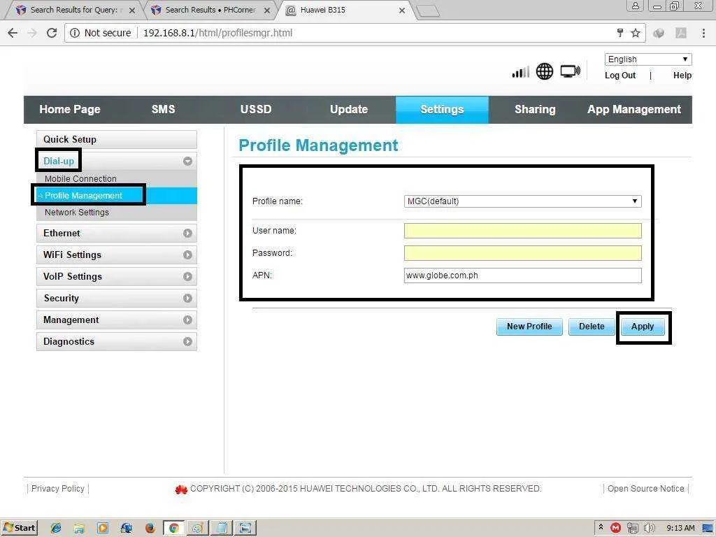

1) Click Dial-up
2) Profile Management
3) Create MGC Apn then hit Apply

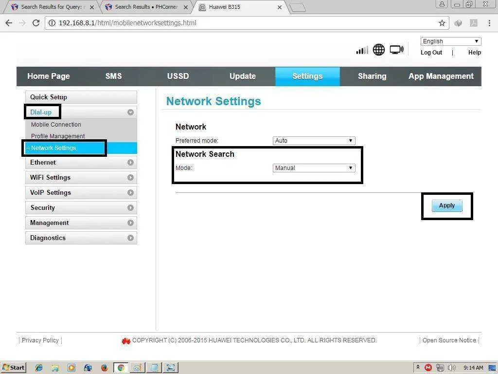

4) Network Setting
Network:
Preffered Mode: Auto
Network Searrch:
Mode: Manual
Hit Apply then eto lalabas

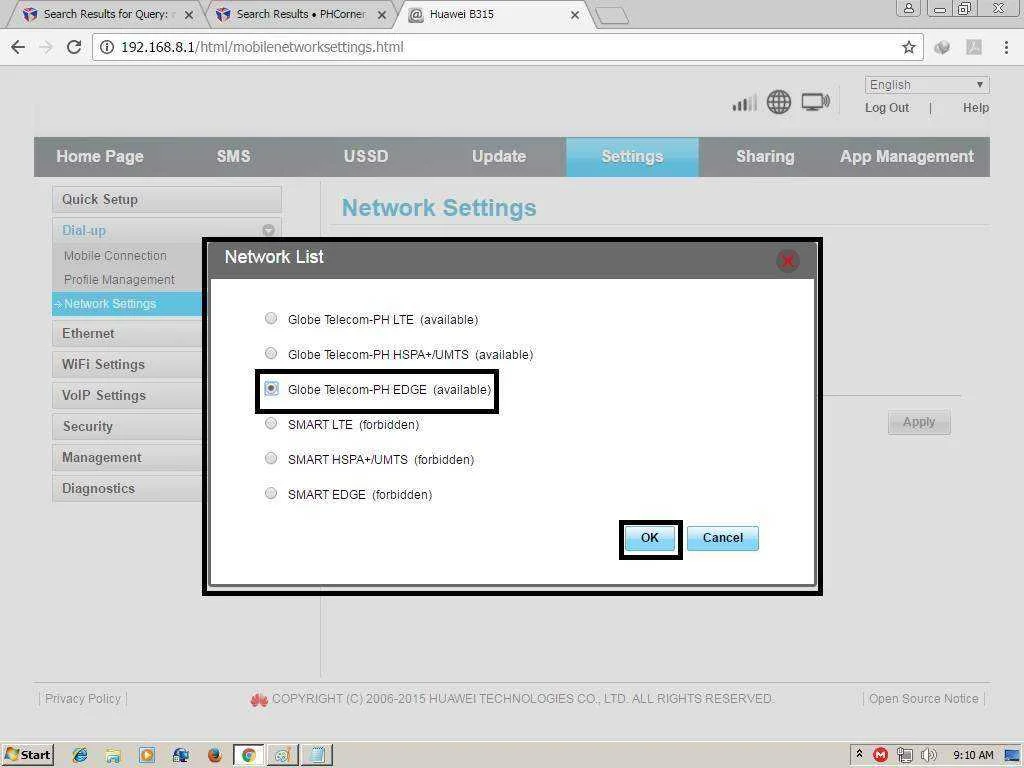

5) Network List
Click either Globe HSPA+/UMTS (3G) or Globe EDGE (2G) to Hunt 10.xx.xxx.xxx IP
After that eto lalabas Registering With Network Please Wait.

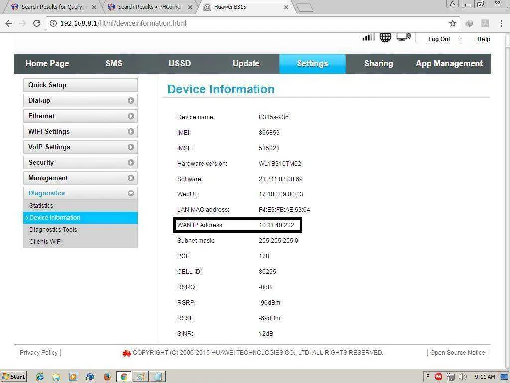

6) Finally 10.xx.xxx.xxx IP has been Hunted

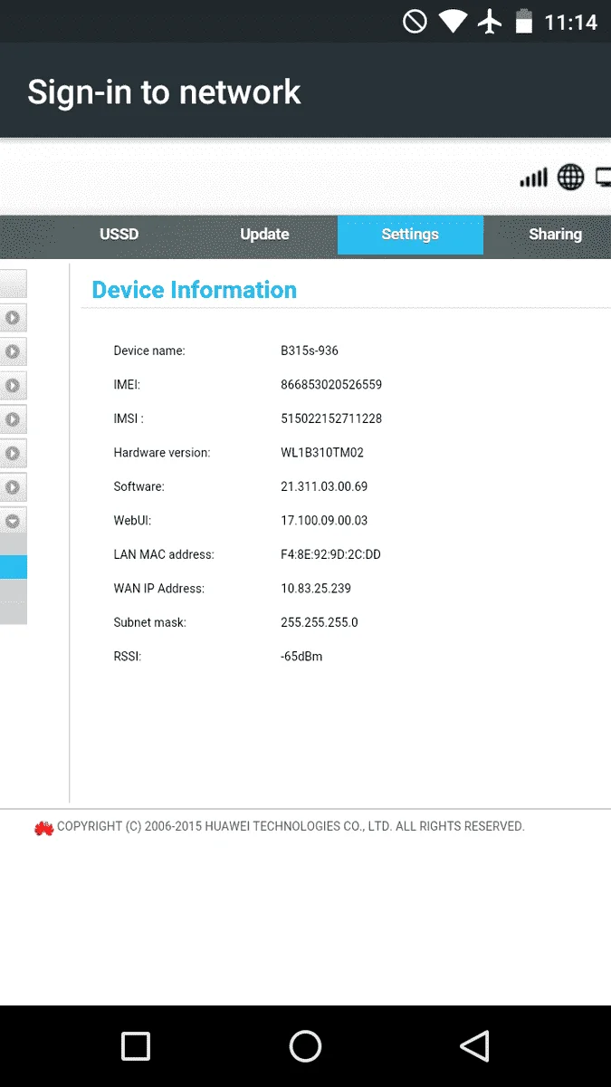

Maraming salamat sir sa page share, nagawa ko po sir gamit lang po cp ko
other way basta may USSD ka naman eh, set to auto ang network, punta lka sa USSD, send code *143# wait babagsak yan sa 3G, OFF - ON data, MGC ip ka na
