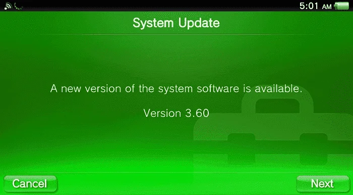

Yifan Lu, one of the authors of HENkaku, wrote a system on the HENkaku servers to help you simply upgrade to firmware 3.60:
Set your DNS to 212.47.229.76 and choose to update from Wi-Fi. Proceed only if the message says “A new version of the system software is available. Firmware 3.60 (変革 Compatible)”. That’s it!
If you’re having issues with this easy way, check the detailed steps below.
Detailed Version

  9. Back out to the main settings screen. Select "System Update" and then "Update Using Wi-Fi."
  10. If you get an error saying your system is up to date, that means either your Vita is on 3.60 already or your Vita is > 3.60 and is not supported by HENkaku
  11. Otherwise you will see a pop-up saying there is a new update. Make sure the message says "3.60 (変革 Compatible)"! If the message does not say that, do not proceed and try to repeat these steps to see if you missed something.
  12. After ensuring you are updating to "3.60 (変革 Compatible)", proceed with the steps on screen to update.
