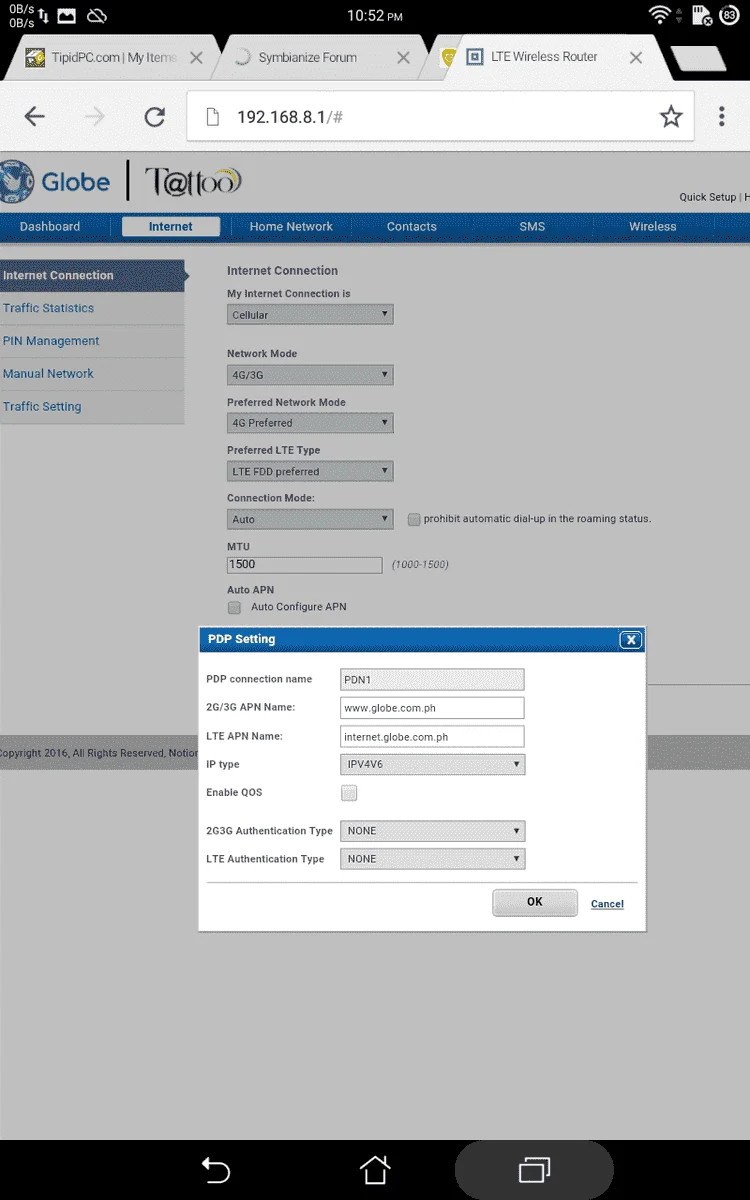

Go to INTERNET > APN MANAGEMENT > ADD profile for SMART LTE
PROFILE NAME: SMARTINTERNET APN- internet- (username/pass none no authentication)
Then go to NETWORK MODE select LTE ONLY
After config go PROFILE select profile na SMARTINTERNET

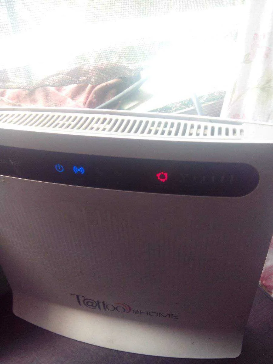

Boss yung sa akin detect nya any sim kaya lng di ako makapagpalit ng apn.ano po kaya problem boss?
