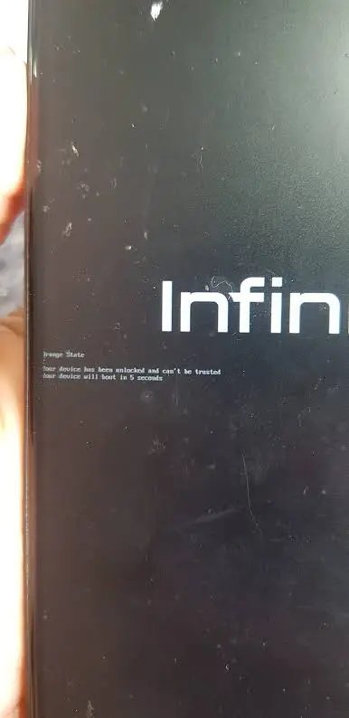

Can someone help me flash my phone that has been in continues bootloop whenever it has power every 5 seconds. I tried to root the phone before, but it seems i did forgot something important that ends up in this issue. Nagtry ako ng iba ibang free procedures/tutorials sa yt pero negats po. Even pag remove ng auth using mtk bypass di rin po kaya, nag eerror lang sa cmd. May nagsabi sakin need na daw ng server to para i-auth flash pero i don't know how. Pa-Help po pls
"orange state your device has been unlocked and can t be trusted your device will boot in 5 seconds"

gumagana po ata sa mtkclient yan, hanap po kayo ng stock firmware file nyan at hanapin yung LK partition then reflash/write it via BROM
ito po yung sa python script auth bypass may error, sa tool naman ayaw mag continue since may interuption den. Continues yung restart nya, repeated na partition backup 1789724520653.webp
hindi ko po sya may flash even while naka brom idk why,nag aauto loop sya
na dedetect ng mtkclient yung device pero nawawala rin po agad
mapahinto ko lang yung pag auto restart neto kahit naka power off or brom tingin ko kaya nato, kaso nag auuto talaga syabasta may power, hanggang ma drain, sakit sa ulo hahhsahshz 😭 😭
hindi ko po sya may flash even while naka brom idk why,nag aauto loop sya.
dalawa lang pag ganto issue; may issue yung mtkclient sa driver or may issue sa preloader. madali lang po kasi i-debug sa mtkclient and madali lang din makikita kung saan nagkakaissue (more debugging logs = easy to self fix). marami akong naencounter na issue magpaandar ng mtkclient kapag windows so lumipat ako ng linux and di ko na rin tyinaga ayusin sa win10.
soft-brick po pag ganito, need tangalin yung power sa board para ma full reset yung preloader at umandar ulit ng maayos or kung di kaya baklasin or walang pangbaklas need i-drain yung battery.
