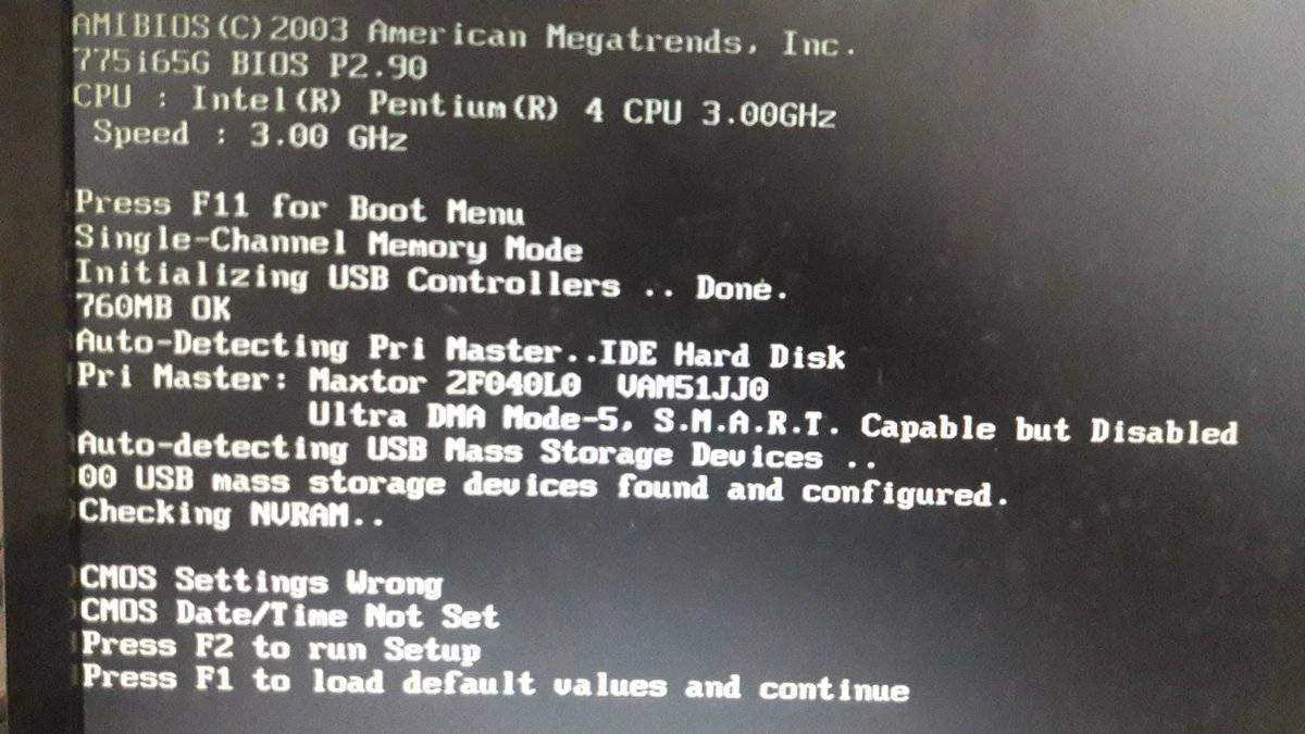

🔒 Closed Computer nag black sreen
reset bios, baka sa startup problem lang
in most cases kasi nangyayari yan kapag may changes in your software or hardware setups
-turn off your PC
-open the case your CPU
-locate the reset jumpers most likely 3 pins others button switch
-press jump the pin to the other side / switch button kindly press
-done
for assurance do the system file check if theres corrupt file in your system
how?
-go to start>search
-type cmd and run as admin
-type in cmd: sfc /scannow
-wait till the process done (automatically fix corrupt system file )
Hope this works(y)
-turn off your PC
-done
how?
-go to start>search
Hope this works(y)
yung sa power po ba na jumper un?
klangan po palitan yung ng cmos battery (cr2032) ,setup mo tamang time at date tapos save and exit...
if d po magsave at ganun padin error din motherboard mo may problem
na tanggal kuna po ang cmos. kaso may ung parang safe mode tapos po yung load previous setting po. na click kuna po lahat kaso lage lang saya ng windows xp
