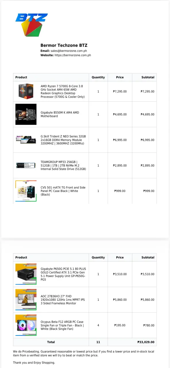

hi, ask ko lang if okay lang ba tong build ko for its price or hindi ba ako lugi rito? main purpose is for multitasking including 5-8 tabs at the same time. pang gaming din like valo, outlast, rdr2, etc. will it run smoothly kaya kahit all low settings? I need your suggestions guys.
ok lang but not parts are not ideal for the budget. you are overspending and underspending at the same time.
underspending ka sa mobo palitan mo ng gigabyte B550M DS3H mas better ang VRM heatsink at dalawa ang PciEx16 slots.
overspending ka naman sa RAM mo. given ang mahal ng mga RAM ngayon due to AI. you dont need 32GB just for 8 tabs. a 16GB can easily handle 10 tabs. Lexar Ares 2x8GB is 3500. yung extra mo sa RAM e dagdag mo sa SSD mo to get 1TB. 500GB is bare minimum lalo na balak mo mag games.
yung case mo ang pangit ng airflow design. walang front or side intake. dagdag ka 200 palitan mo ng CVS Emirsun.
lastly yung monitor. 27inches with 1080p res medyo pixelated yan. for ideal monitor 24inches sa 1080p or 1440p sa 27inches.
this is only subjective. kung gusto mo tlaga 27inches kahit 1080p lang thats okay.
this is based on bermor since bermor yung pricelist mo.
take note it will NOT run smooth on any heavy AAA games even on the lowest settings but some are playable with FSR.
Valo = no problem
outlast 1 and 2 = good
outlast trials = playable with FSR ON
RDR2 = playable with FSR ON
Valo = no problem
thank you paps super informative nito
Valo = no problem
but for gaming would you suggest to keep it on 32 since balak ko naman upgrade ng gpu soon, or goods na talaga 16gb?
for gaming ok na ang 16 most of the time. and if ever naman gusto mo tlaga mag 32GB. 4 slots naman yung mobo. pde ka pang bumili ng another 2x8GB if may xtra kana. para maging 32GB lahat. bali 4x8GB. wala naman issue dun. etong RIG ko nka 48GB. 2x8GB yung starting RAM ko taz nag dagdag ako ng 2x16GB. since need malaking RAM sa video editing.
