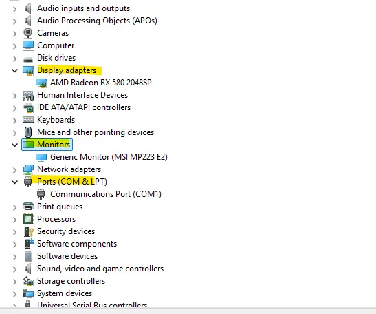

check mo device manager kung nadedetect display port connection, if yes try mo uninstall then refresh driver para ma install generic drivers. pag ayaw either display port (monitor/gpu) or dp cable may issue

ay san banda makikita tong display port connection sa device manager?1761658554360.webp
