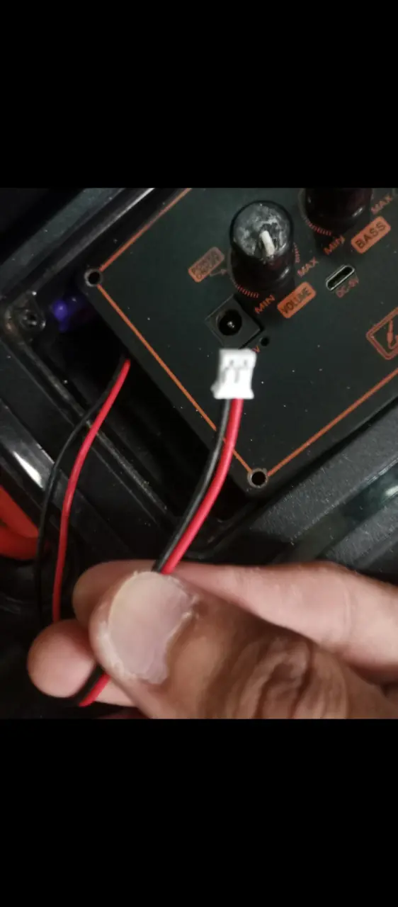

Dalawa ang options mo diyan:
1. Putulin mo isa-isa yung mga wires nila at pagpalitin, pagdugtungin mo yung mga wires isa-isa at lagyan mo ng shrinkable tubes o electrical tape. Huwag mong puputulin ng sabay para maiwasan silang magshort.
2. Kung saktong magkapareho ng size yung mga metal parts nung mga plugs, pwede mo silang pagpalitin, check mo dito sa picture kung paano:
putulin mo nalang yang plug and i direct mo na pag connect yung both wires, no problem naman yan since same voltage lang naman.
gamit ka nalang electrical tape, or much better heat shrink to secure it. balatan mo lang yung wire then twist, if gusto mo manood ka sa youtube ng wire splicing para sa tamang pag connect ng wires.

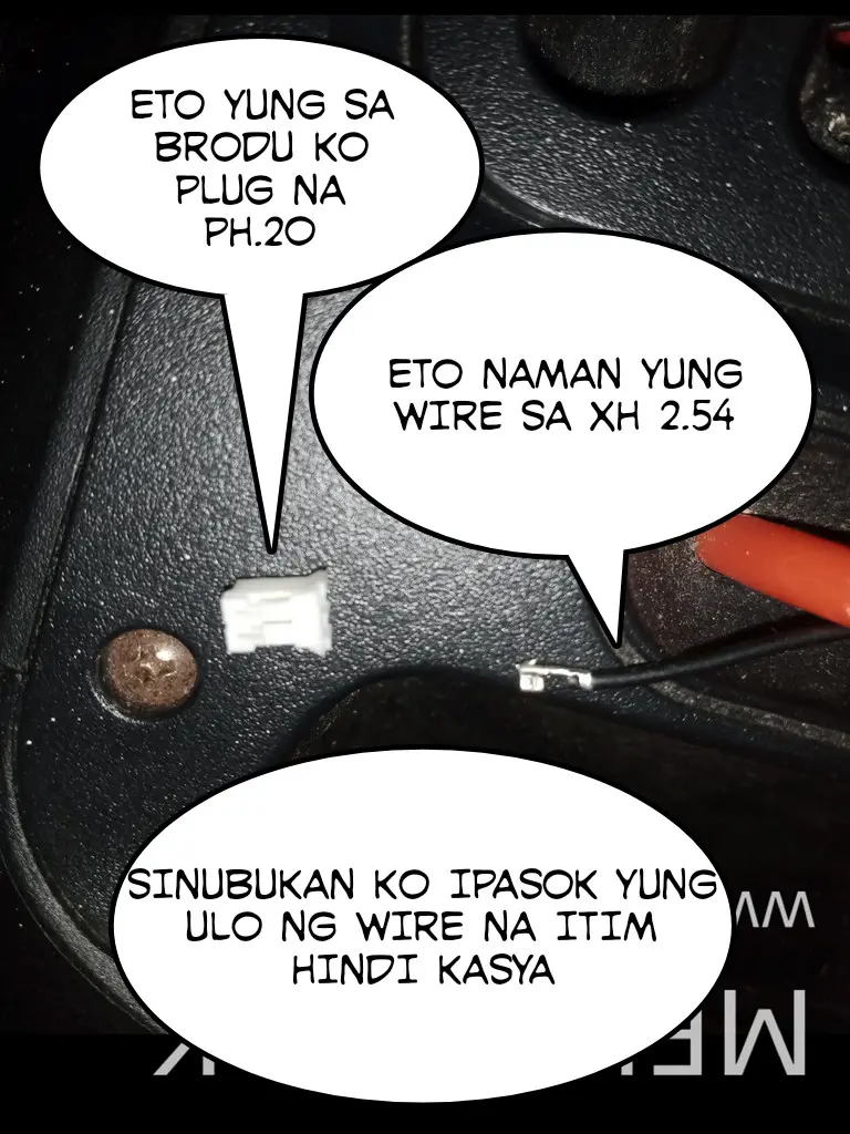

Boss sinubukan ko yung
NUMBER 2 STEP MO
hindi naman magkasya sa
ULO NG PH.20
yung
METAL PARTS NG XH 2.54
medyo malaki kase kaya hindi mapasok sa loob
Ayos !!!!
pwede pala balatan at ipagkabit yung mga wire na redblackyup
thanks sa inyo mga bossing :-) :-)
subukan ko bukas....
SALAMAT MGA PARE

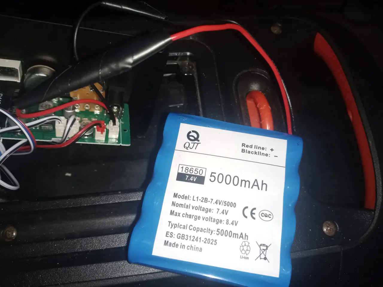

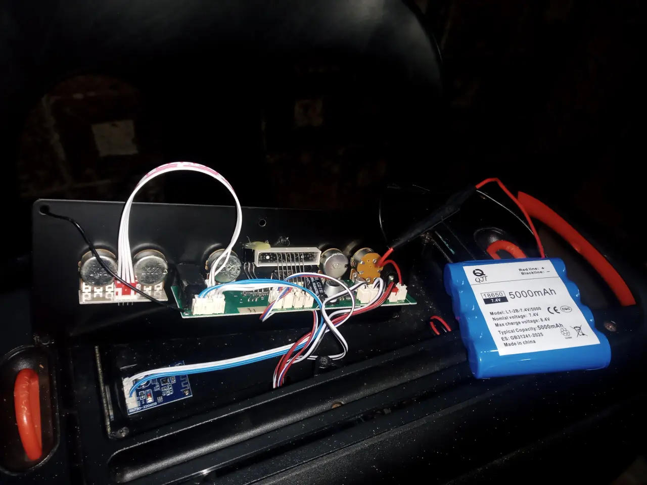

Dahil MISSION COMPLETE NA
View attachment 3917044View attachment 3917047
At ilang oras ba . Bago ma FULLCHARGE ito ????
Congrats!
yung speed ng charging is naka depende sa charger mo, you can check the information sa charger mo, i think ang ginagamit na charger diyan is possibly mga 3-5A.
since you have 5,000mAh
use the formula: Time (hr) = Battery Capacity (Ah) / Charger Current (A)
5Ah (5,000mAh) / 5A (Assuming the charger is 5A) = 1 hour of charging before full (Theoretically)
just add the margin of error to the power loss due to heat, in real world charging would take around 1 hour and 15 mins up to 1.5 hours.
