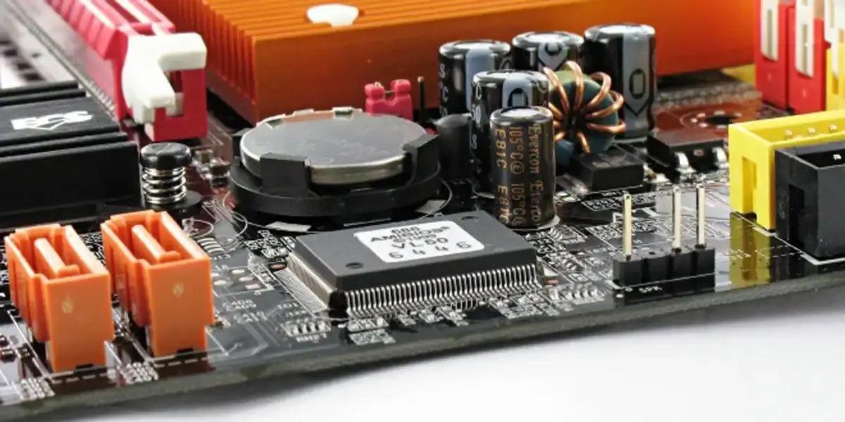

Pano po mag safemode lods? And pc po ito, di ko matanggal battery :( tried opening and closing it for a few rimes pero walang effect eh
