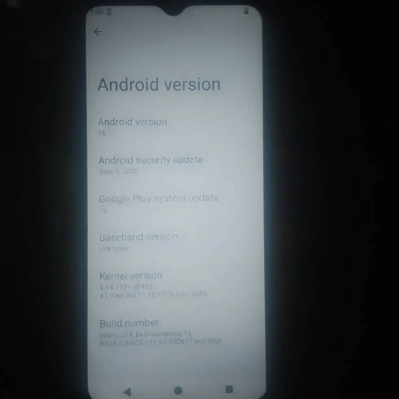

Realme C11 2021 unisoc rooted+ installed android 16 gsi

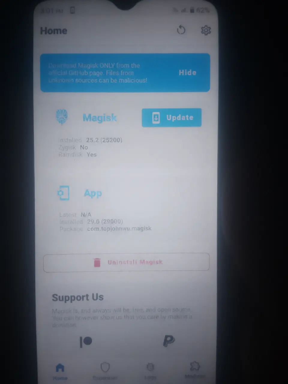

To root ur unisoc realme c11 phone u need to download stock v119 firmware after u download it there will be a research tool zip inside use it to flash the system click the gear icon change only the boot.img with the ρá†ch boot.img I will provide then flash 5-10 mins first boot set up the phone open developer options turn off automatic system update don't update ur phone unless u want to make ur phone bootloops

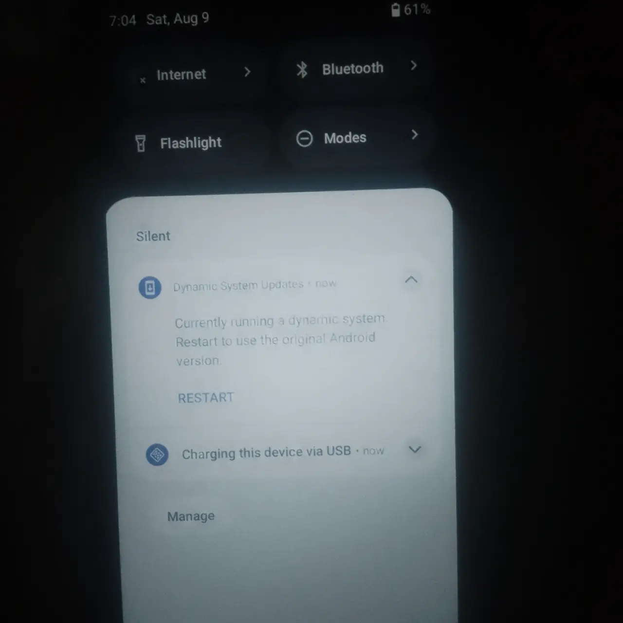

Gsi tutorial If u want ur phone to boot in Android 16 gsi downloade a64 gsi or arm32binder64 gsi if u don't want it to flash permanently use dsu sideloader grant root access via magisk also download termux and type this su setenforce 0 this will make ur phone permissive to boot on gsi if u will not set this command ur gsi will not boot and it will boot to ur stock rom
