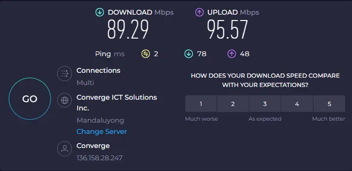

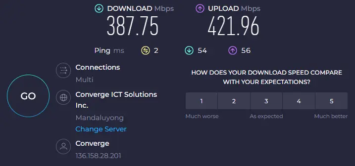

Pahelp pano maging same yung speed nila. Pag nakaconnect ako sa router namin which is TP Archer A5 ang nakukuhang speed lang ay almost 90Mbps 5g connection. Ngayon sa main router naman which is yung mismong converge na direct sa poste ay nakukuha kong speed 300-400Mbps. Pano gagawin? Please ang laking speed loss kasi niya.
SAME TEST KO SA 5G CONNECTION HINDI 2.4G. Gusto ko lang malaman bakit ganon biglang liit speed sa TP router
TP ROUTER SPEEDTEST 5G CONNECTION:
CONVERGE MODEM SPEEDTEST 5G CONNECTION:

assuming you have piggy-backed your Archer via Ethernet cable, it looks like a 100 Mbps link between your converge and tp link routers. check the ports that you're connecting them both with - ensure na gigabit nga 'yung ports nila... then check the cable you're using.

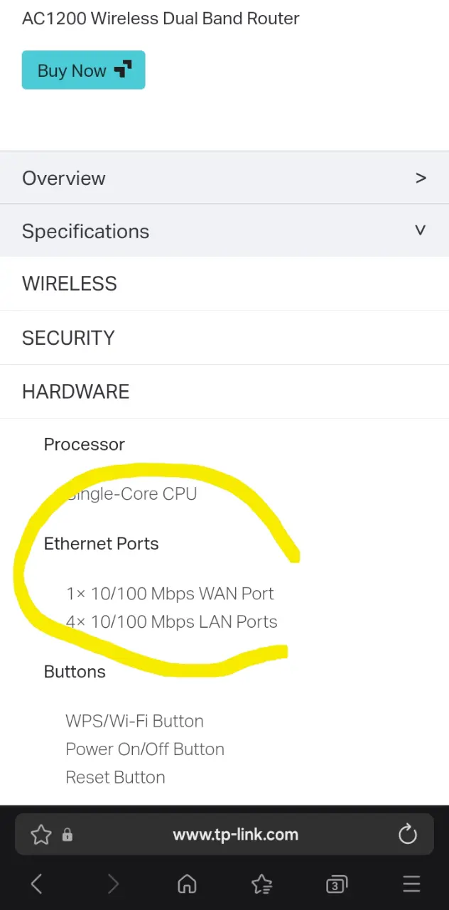

Edit: Archer A5 only has Fast Ethernet ports (10/100 Mbps). there's the reason why.
ibig sabihin po nasa router yan?
that's what it looks like.
kung ang setup mo ay:
[Converge Router]---<LAN Cable>---[Archer A5]
maximum port speed ng A5 ay 100 Mbps, kaya 'yun lang ang kaya i-provide nito sa mga clients na connected sa kanya.
check mo specs ng Converge router... kung may gigabit ports ito, ang kailangan mo lang palitan ay 'yung Archer A5.
