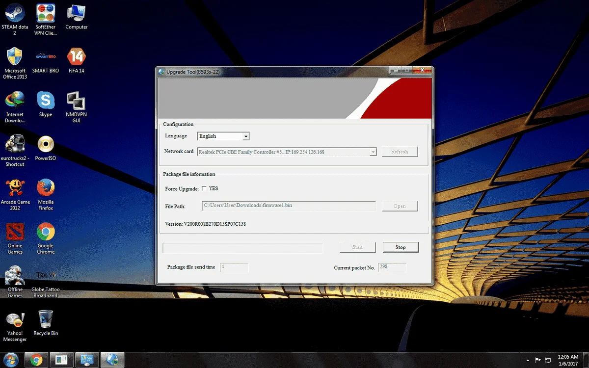

And this are the firmwares that i have tested
(if you guys planning to use any firmware here, flash it at your own risk!!)
Original Firmware (V200R001B270D15SP07C158 | Nov 4 2014) (locked to globe)
the only working firmware that works up to 5 bars using multicast tool
Universal Firmware:
i only get up to 2 bars here
Universal Firmware: (hexed)
getting up to the 4th bar (4th bar keeps blinking)
Tool:
Note : Firmware update can damage your device, so before changing the firmware make sure you know what you are doing.
Additional Info:
Working po pung Prepaid LTE
Working po pung CDC + Proxy ( possible na ma blocked si sim)
:rofl:success.. na bricked ko na modem ko. nag flash ako ng backup firmrware, pagdating sa sa 4th bar, ni hard reset ko ng paulit ulit.. hanggang sa power led na lang yung nailaw. tulalais na siya.. pag hold ko naman ung wps+wlan, 3steady bar siya and ung 4th blinking
ang problema hindi ko pa rin ma-access si SSH or TELNET
yung ip add ng modem ko 169 na.
nag set na rin ako ng static sa ip sa pc ko. sinubukan ko yung 192.168.1.1 and 192.168.254.254 magkatulad sablay..
(y)
ano magandang gawin maliban sa itapon ko na to?
