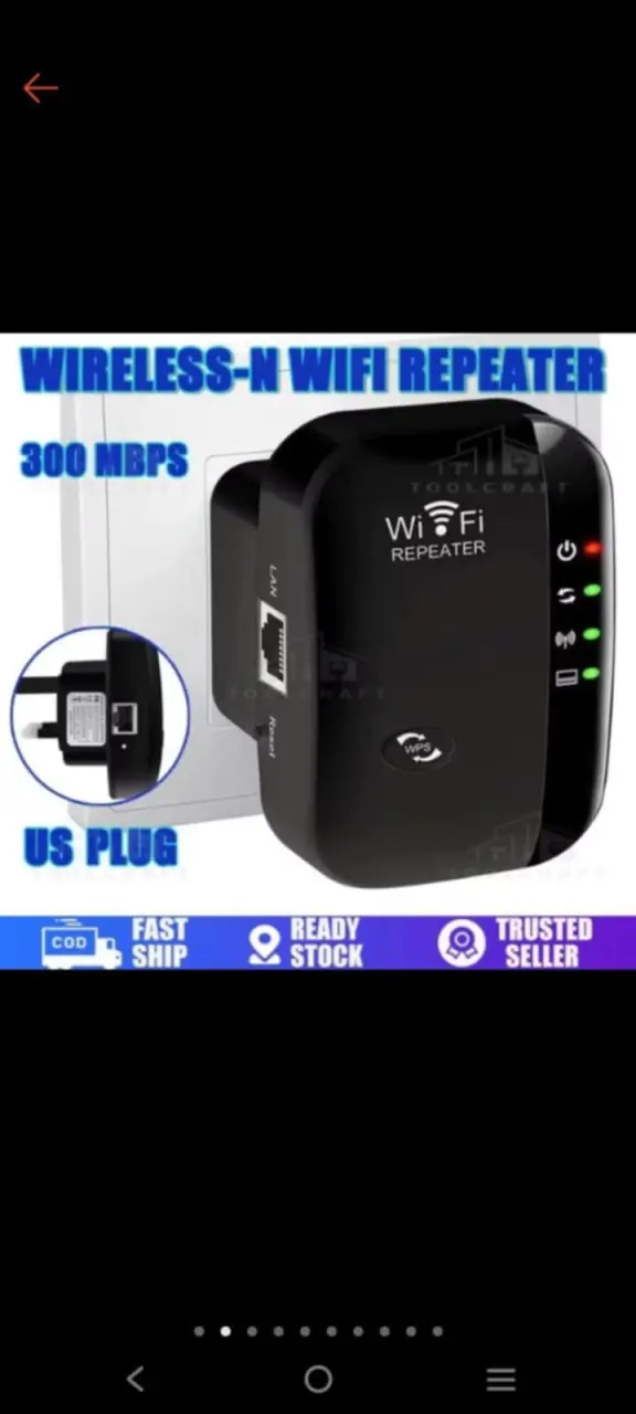

❓ Help (Q) lang sa wifi refeater
Ang maximum number of devices na maaaring i-connect sa isang WiFi extender ay depende sa model at specifications ng extender na iyong ginagamit. Karaniwang, ang mga WiFi extenders ay may kakayahan na i-connect ng hanggang 10 hanggang 50 devices depende sa model. Para sa eksaktong bilang ng devices na maari mong i-connect sa iyong WiFi extender, maaari mong tingnan ang dokumentasyon o manual ng iyong extender. Kung hindi mo makita ang impormasyon na iyon, maaari kang tumawag sa customer support ng manufacturer ng iyong WiFi extender para humingi ng karagdagang impormasyon. Sana makatulong!
make sure you know what you're getting. 'yung 300 Mbps ay theoretical maximum ng 802.11n. and that's under the best of conditions.
ngayon, this being a repeater... the best throughput scenario is half of that - 150 Mbps. if you do not have the best case scenario, it will be less than that. and keep in mind that that throughput is what you'll be sharing amongst your devices.
if your use case is to extend wifi coverage from one end of your house to another, you'd be far better served by having multiple access points.
