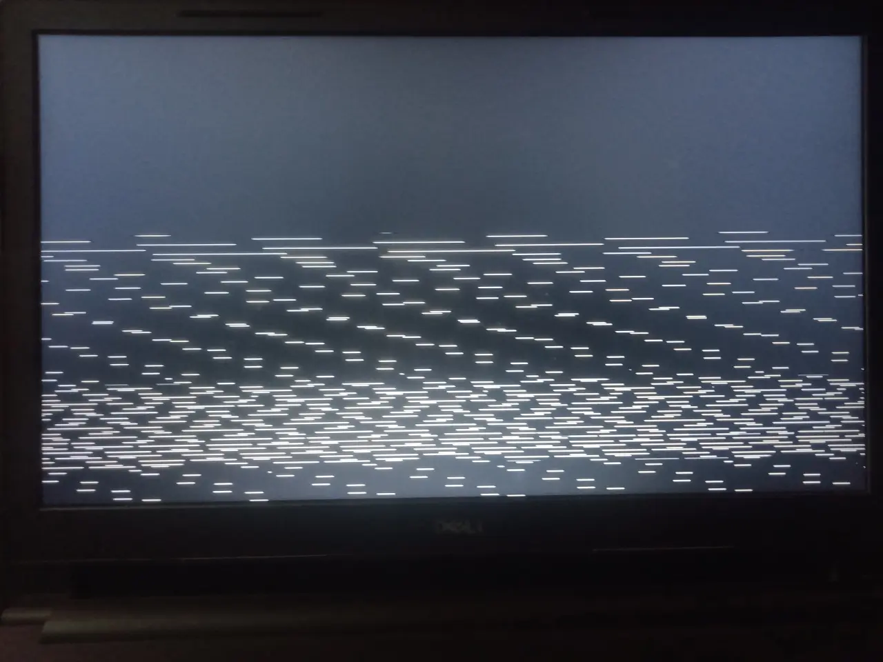

❓ Help Pahelp po sino naka encounter nito distorted lines when installation of windows using bootable usb
Vermouth the Gin
✌𝓝𝓮𝓿𝓮𝓻 𝓑𝓮𝓽𝓽𝓮𝓻 ✌
pahelp po sino naka encounter ng ganito distorted lines when installation of windows iso using bootable usb?
pahelp po paano i fix nka ilang usb na ako same problem pati nag download nko ng mga ibat ibang version ng iso same problem pa rin
maraming salamat po sa help!
stock os ba yan boss? or upgrade/downgrade yan
napalitan na kasi to ng ssd from hdd boss from technician, importante lng sakin boss na ma open to bahala na 22h2 or 21h2 na windows version gusto ko sana ma open yung laptop at i back up yung mga files tpos mag clean boot na nmn
na stock kasi ako sa automatic repair dahil nka ilang force shutdown dahil ayaw mag start kasi loading dahil napuno n pala yung primary storage 6mb nlng natira after nka ilang force shutdown ayun nag automatic repair nag search2 ako anong solution wla ako mahanap clean installation lng din na try ko before
maraming salamat po sa pagsagot lods
may working iso kaba jan lods? bka pwede pahelp ni try ko i create yung iso ng windows 8 to check kung iso ba problema ayun nawala din yung distorted lines kaso windows 10 kasi laptop
kasi boss i strongly suggest you use the stock version of OS first para iwas error, say if lappy is manufactured using win10 as OS then win10 din dapat i-install, not win11 or win8
wla akong stock lods from internet lng ako kumuha ng iso sa microsoft na site. tpos using flash drive lng meron ako wla ako nung dvd drive installation
marming salamat sapag sagot lods
