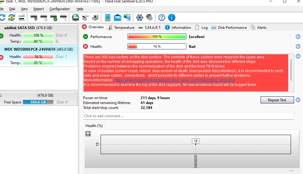

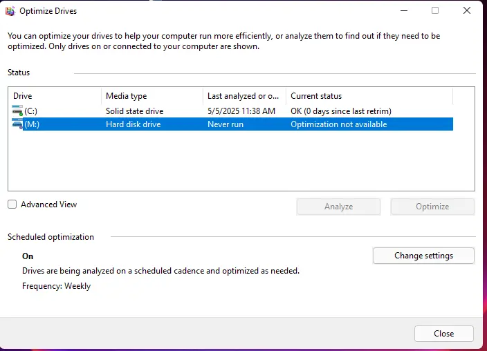

❓ Help Mga boss how bato need kasi ma kuha laman corrupted na sha ayaw na ma detech ng system tas mabagal (HARD DRIVE)

TS, ensure mo na maayos yung connection niya sa computer, i-reseat mo yung HDD (or SATA cable) tapos i-check disk mo siya sa CMD Prompt (Admin), type chkdsk m: /f.
Maaaring magtagal ang process, hintayin mong matapos at huwag mo siya i-interrupt, otherwise hindi mo na siya made-detect.
ayaw nag spspin sha pero nag cliclick bumibitaw connection bigla didisconnect tas connect uli di kona alam pano i babackup nakikita namn files nya pero di na oopen
Ano ba siya, internal hdd or external drive? Inspeksyonin mo yung terminals baka may maluwag o nag-crack na solder joints. Kung cable ang gamit na pang-connect, try mo isaksak sa spare na port. Try mo ding palitan yung cable mismo.
Kung external drive siya, try mo sa ibang computer i-check disk.
ung hdd ismo bumibitaw like mag spispin sha for a couple of minutes den iingay sha tas disconnect tas reconnect uli corrupted sha may need lang na important files na need icopy
