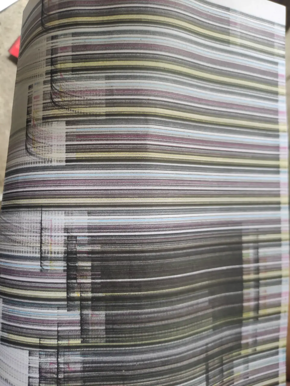

❓ Help Epson L3210
Hello! It seems like you're having an issue with your printer after cleaning it. Could you please provide more details about the problem you are facing with your Epson L3210 printer? This will help me understand the issue better and provide you with the appropriate solution.
try mo muna e cleaning yan thru pc operate mo lang sa settings if same parin better dalhin nalang sa shops na nag kcleaning baka may problem yan sa print head sa loob
Okay pa ba yan? O shorted na yung board?
Tatlo lang yan eh.
1.) May sira yung flex.
2.) Sira/Shorted Printhead.
3.) Madumi yung printhead at need cleaning.
Paanong no power? Palit power I.C. o yung button?
O software error? Dapat talaga bili na rin ng pamalit board.
Kahit ako ngayon palit transistor i-test ko pa mamaya.
Nag short kasi head bos kaya plit ako 2 transistor at power ic. Tpos Nung naayus na gnyn na print hehe. Di ko alam Anong sira , kasi sa tgal ko din nag ggawa now lng ako nkaranaa gnyn print out saakit sa ulo haha
Na-try na ba head clean ulit hanggang 3 beses?
Kung wala pa rin no choice need palit board na yan.
Pero pa-check na rin sa printer technicin para sigurado.
