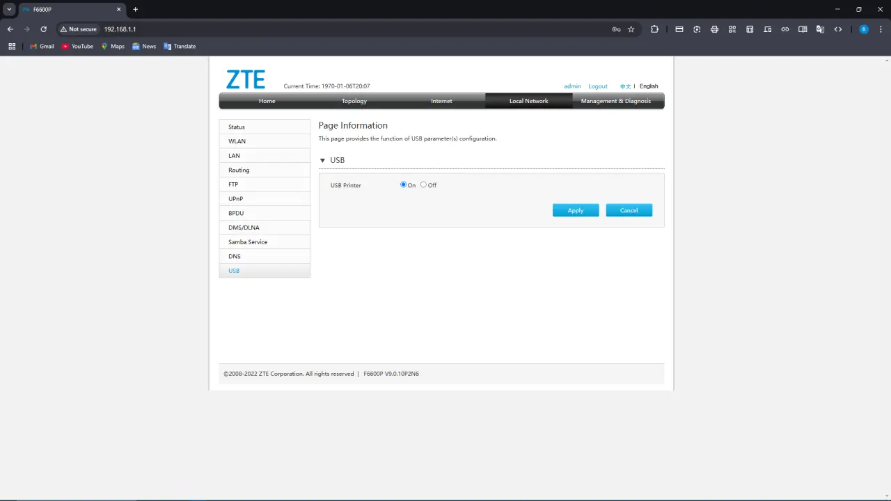

Go to chrome type 192.168.1.1 to enable printer.

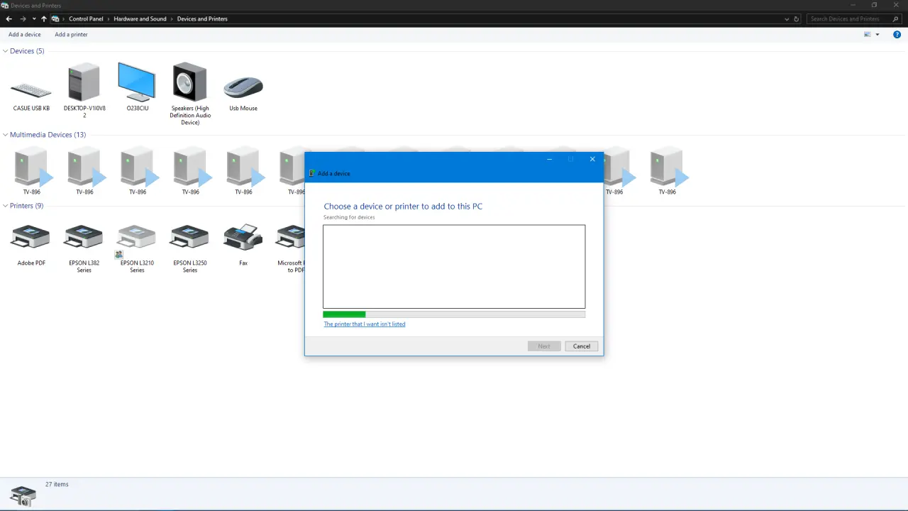

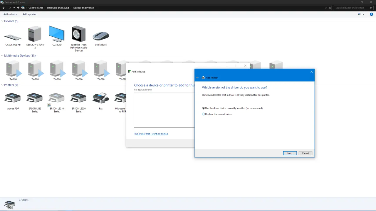

1. Control panel.....hardware and sound.........device printer........add printer.
2. Click "The printer that i want isn't listed"

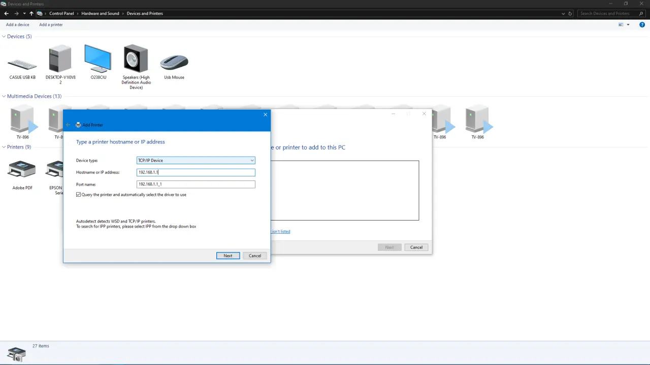

3. Click "Add printer using IP" ..............NEXT
4. Select TCP/IP then ip gateway yung mismong ip ng router niyo default (192.168.1.1)

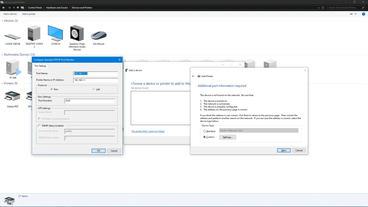

5. Click CUSTOM then setting default (RAW 9100)wala ng babaguhin.....click OK
6. Click NEXT..wait a second.

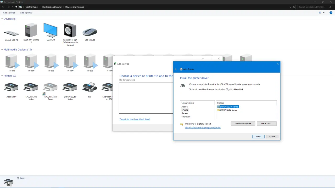

7.Click NEXT..no need to replace...............NEXT
2. PRINTER NAME (bahala ka sa buhay mo) then NEXT...NEXT.....FINISH.

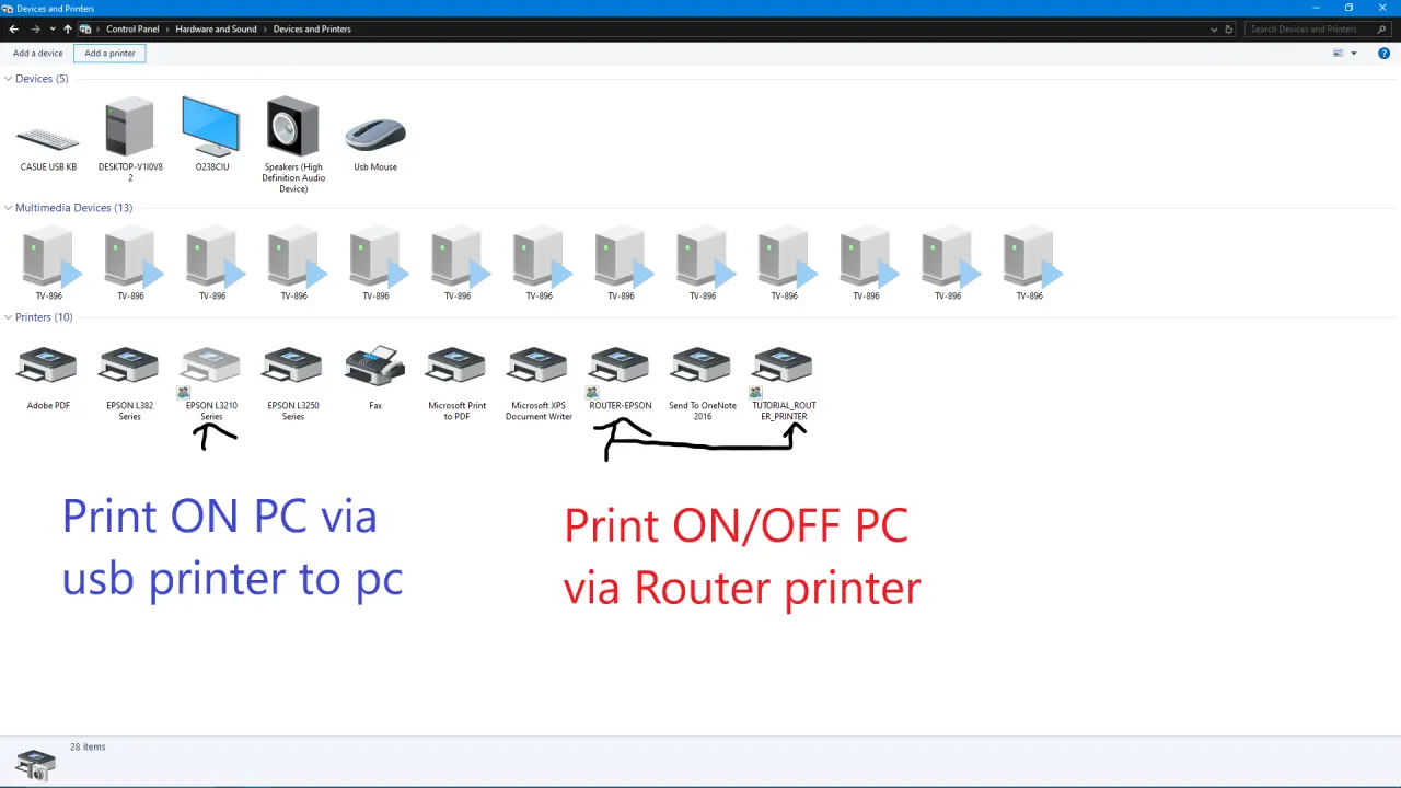

This method is for double purpose:
1.If someone using your pc you can print via android phone using (NOKO PRINT) as long na detected yung shared printer mo sa "OPEN PC"
2. You can print via phone using (DROIDBOT) apps if your "PC is CLOSE".
Sa damikong na download na printer apps na pwedeng gumana yung printer kahit patay ang pc, eto lang ang gumana droidbot wala ng iba......

Yung DROIDBOT diko masyado recommended...kc akala mo nasira printer mo kc kahit tapoz na nandun padin yung paper......ginawa ko pinipindot ko lang ulit yung ON button para lumabaz......for emergency ko lang ginagamit.
