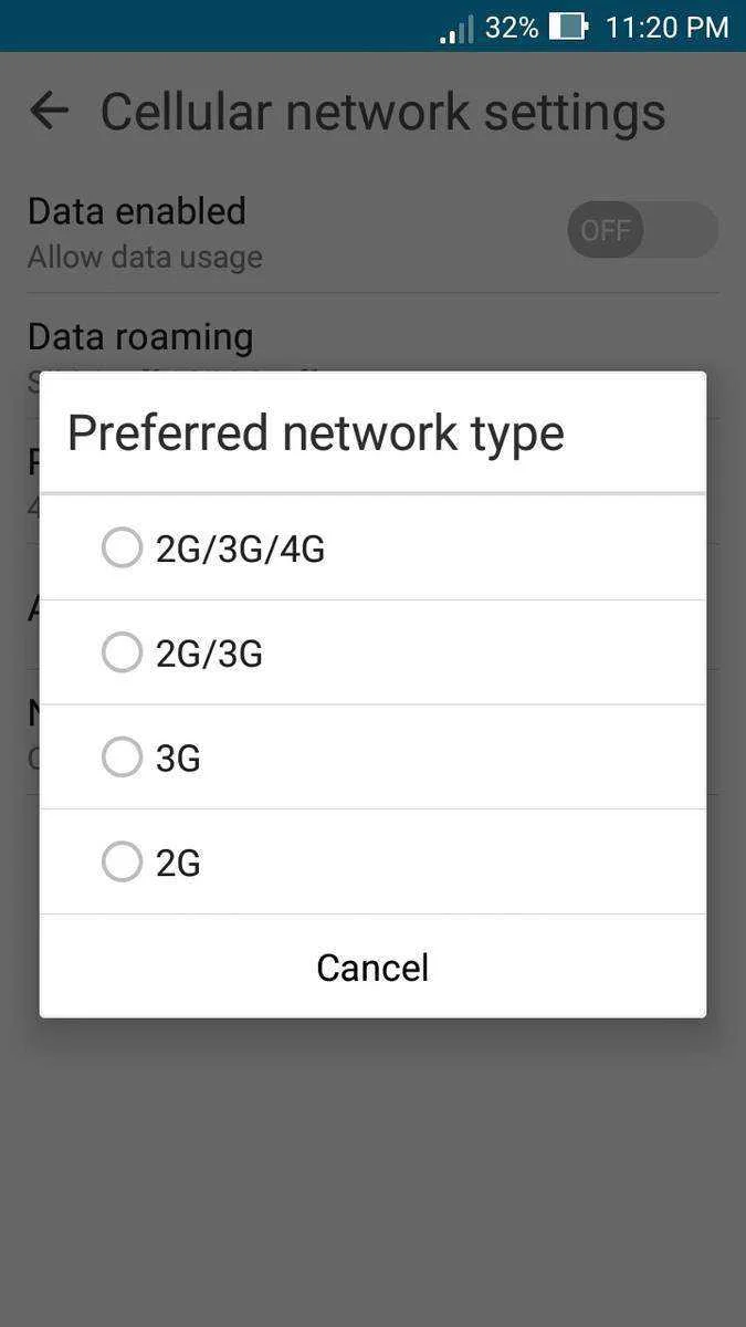

  7. Finally, select 4G ;) WCDMA (Means 3G) , GSM (2G ) , LTE (4G)
Now, some phone might not have a stand-alone 4G Network Type :cry: as shown on my screenshot below instead meron lang sya nung Combination Type na 2G/3G/4G which automatically choose kung ano ang available network. That's the purpose of Method 2 & 3, Pipilitin natin syang maging 4G/LTE. :D
Since my phone does not support a standalone 4G LTE Network, as shown above, I resorted to another trickier method to achieve the same goal which is to lock the signal.

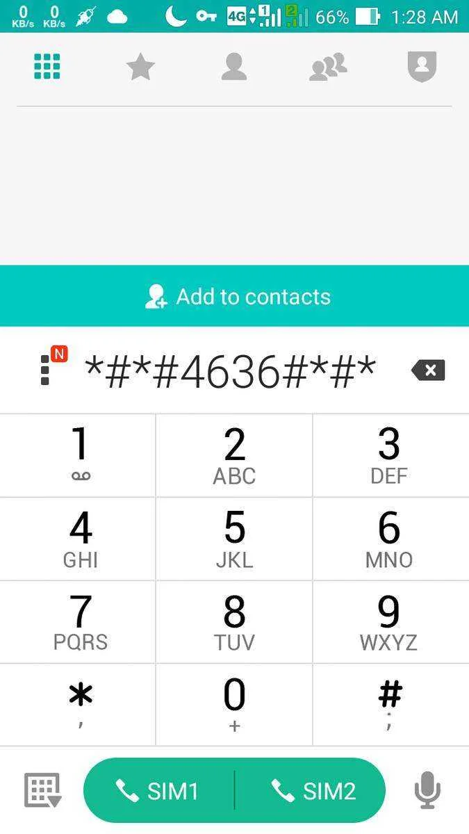

Now, dito na tayo sa Android Codes
NOTE : NOT ALL PHONE SUPPORTED THIS CODE
Just dial *#*#4636#*#* then may Pop-up Window na lalabas showing a list or something similar below. The Pop-up Menus might differ for different phones kaya wag kayong mag panic.

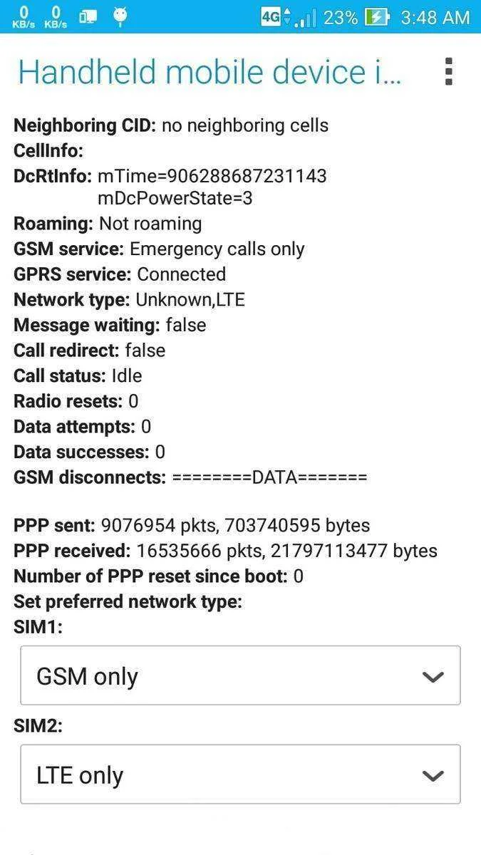

Now dun tayo sa 'Phone/Device Information' then dun sa 'Set Preferred Network Type' and simply choose 'LTE Only' to force locked the signal to 4G/LTE. If Dual Sim kayo, make sure na yung papalitan nyo ay yung gamit nyo sa Data Connection kasi kapag hindi iyon yung na-change nyo, babalik lang sya sa Default Setting (in my case GSM only).

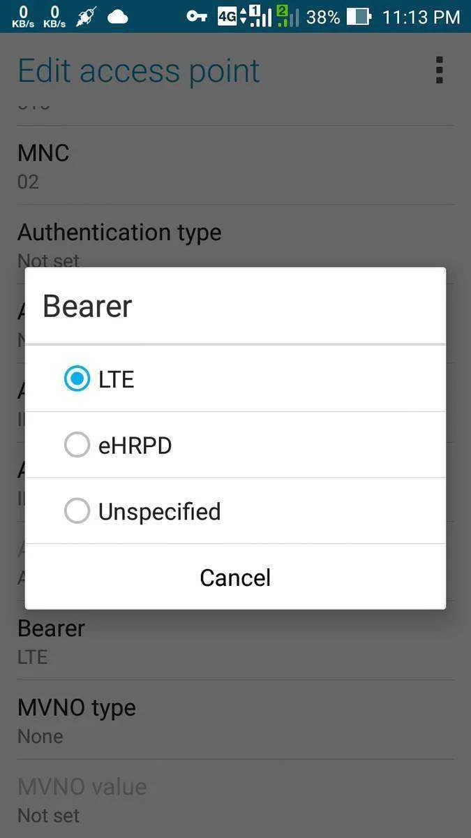

  7. Then you have two options at this point. FIRST, either papalitan nyo lang ang BEARER ng kasalukuyang Access Point na gamit nyo or SECOND, gagawa kayo ng bagong APN. if yung FIRST napili nyo, click your preferred Access Point then proceed to #10. If SECOND naman, continue to #8.
  8. Now after clicking yung appropriate SIM, click yung PLUS sign (+) sa taas kung meron at mag-ADD lang ng new APN. If walang PLUS sign (+), either yung 3 DOT, or 3 BAR then Select ADD or ADD NEW.
  9. Input your preferred Settings or anything na appropriate sa Name, APN (eg. Globibo Def Prepaid ~ internet.globe.com.ph; Globibo Def Postpaid ~ http.globe.ph; Globibo MGC ~ You do not have permission to view the full content of this post. Log in or register now.) Proxy if possible or kung gusto nyo okay lang din naman kung walang Proxy.
  10. Now Scroll Down and look for BEARER. By default it is UNSPECIFIED so papalitan lang natin sya ng LTE.
  11. Finally, SAVE!!!

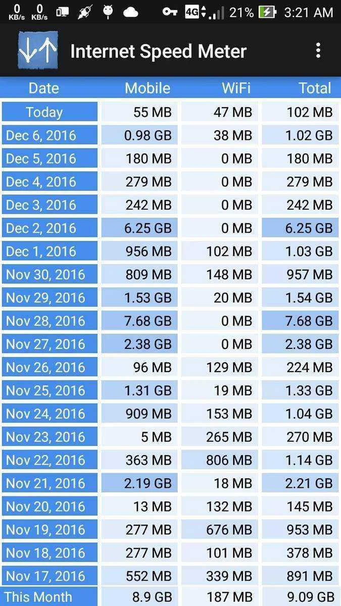

~ It's a little bit of a hassle sa pag connect pero sulit na sulit naman sya kapag nakaconnect ka na. I've been using a single Local IP for 10 days and counting, no DC. Downloaded a whole lot of files already. So it's time for me to share it. ;)
As you can see, my network type is lock to 4G LTE, also my pkts recieved during those 10 days of experimentation is 21797113477 bytes = 21GB tugma naman sa Mobile Data Usage ko sa taas di ba. :X3:

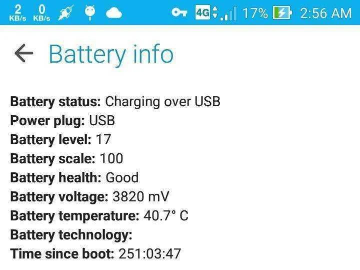

Up Time of 251hrs without reboot = no change in IP
