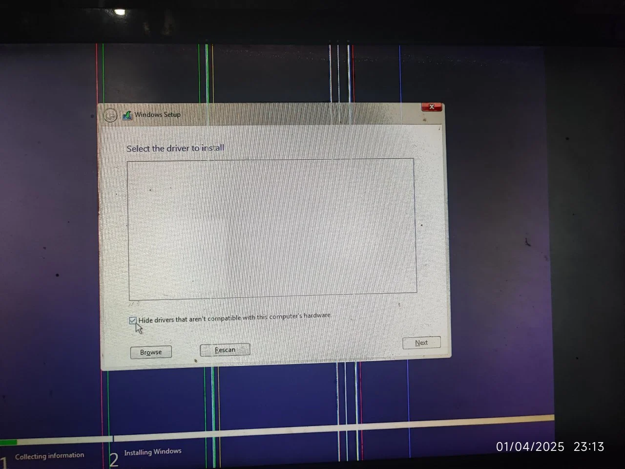

wala pong lumalabas na drivers nag download nako ng msi driver pero wla parin nalabas puro ganyan lng please help po

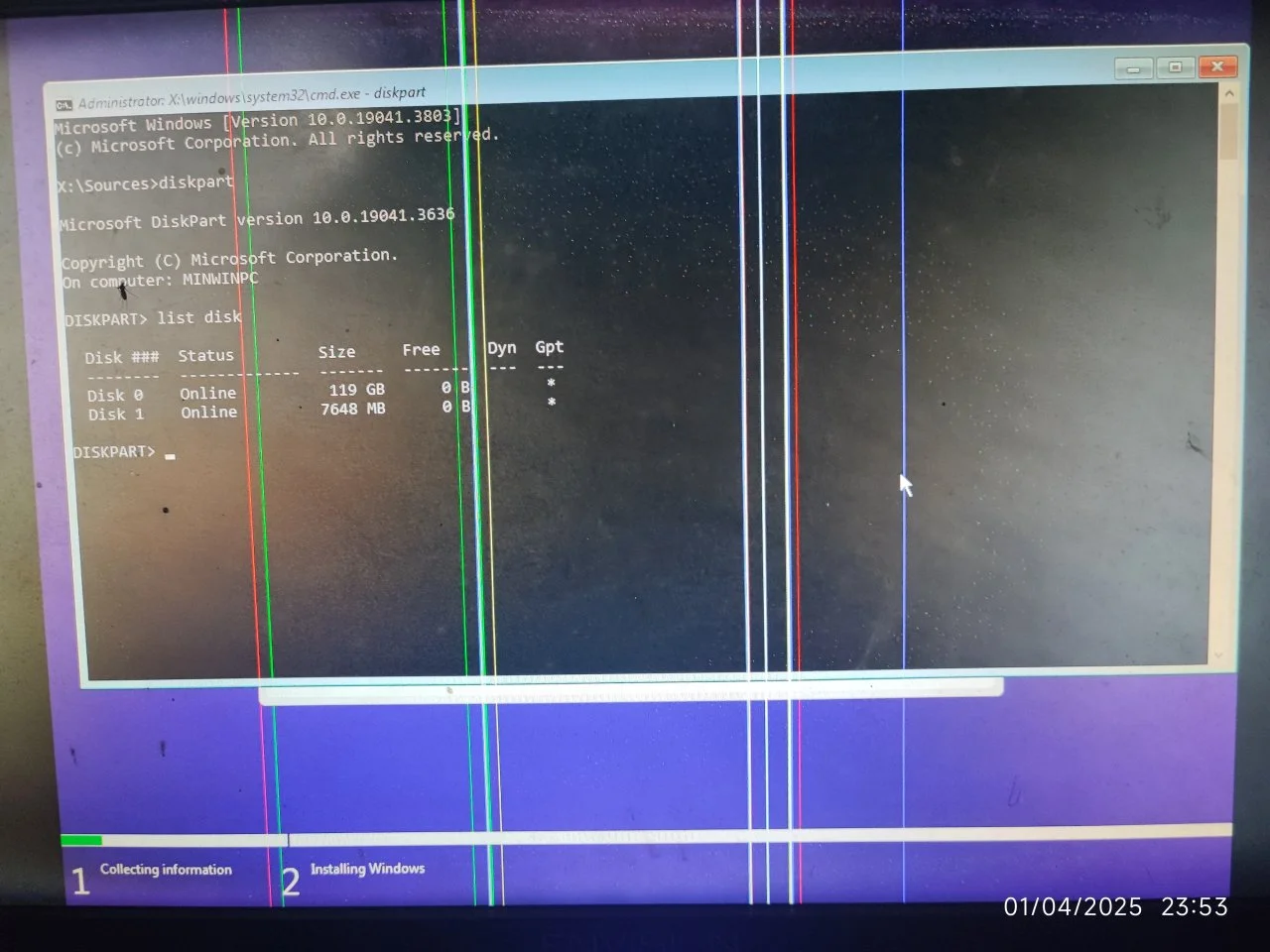

Well if detected ssd niyo sa bios supposedly lalabas yan sa list ng drive na maiinstall.
Check niyo if naka uefi or legacy boot kayo if uefi latest na mga laptop gpt yan then pag old usually mbr. Sa bios located toh.
After nun access cmd during windows installation try niyo shift+f10. Tas type ung sa baba isa isa
diskpart
list disk
sel disk kung ano ung pag iinstallan niyo ng windows (ex: sel disk 0)
clean
convert to mbr (legacy) or gpt (uefi)
try to restart ung installation.
If di niyo nakita list ng disk niyo after list disk may problem sa ssd niyo.

parehas nmn na po nka gpt pero ayaw parin nya makita, bago po yyng ssd
walang enter product key or select upgrade or custom install ganung select where do you want to install windows?
