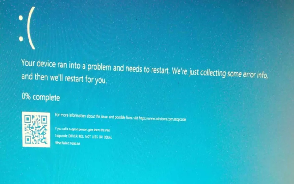

❓ Help Help BSOD DRIVER_IRQL_NOT_LESS_OR_EQUAL
sebolok
Eternal Poster
Baka my alam kayo paano ayusin ito
Upload ko na rin yung error nya
Download na lang dito: You do not have permission to view the full content of this post. Log in or register now.
Ito pala details ng error nya:
DRIVER_IRQL_NOT_LESS_OR_EQUAL (d1)
An attempt was made to access a pageable (or completely invalid) address at an
interrupt request level (IRQL) that is too high. This is usually
caused by drivers using improper addresses.
If kernel debugger is available get stack backtrace.
Arguments:
Arg1: 0000000000000000, memory referenced
Arg2: 0000000000000002, IRQL
Arg3: 0000000000000000, value 0 = read operation, 1 = write operation
Arg4: fffff80315bc818e, address which referenced memory

BUGCHECK_CODE: d1
BUGCHECK_P1: 0
BUGCHECK_P2: 2
BUGCHECK_P3: 0
BUGCHECK_P4: fffff80315bc818e
FILE_IN_CAB: 112324-9734-01.dmp
FAULTING_THREAD: ffffa90af33cc080
READ_ADDRESS: fffff803122fb390: Unable to get MiVisibleState
Unable to get NonPagedPoolStart
Unable to get NonPagedPoolEnd
Unable to get PagedPoolStart
Unable to get PagedPoolEnd
unable to get nt!MmSpecialPagesInUse
000000000000000
BLACKBOXBSD: 1 (!blackboxbsd)
BLACKBOXNTFS: 1 (!blackboxntfs)
BLACKBOXPNP: 1 (!blackboxpnp)
BLACKBOXWINLOGON: 1
CUSTOMER_CRASH_COUNT: 1
PROCESS_NAME: System
SYMBOL_NAME: NETIO!NetioDereferenceNetBufferListChain+104
MODULE_NAME: NETIO
IMAGE_NAME: NETIO.SYS
IMAGE_VERSION: 10.0.19041.4355
STACK_COMMAND: .process /r /p 0xffffa90af3075080; .thread 0xffffa90af33cc080 ; kb
BUCKET_ID_FUNC_OFFSET: 104
FAILURE_BUCKET_ID: AV_NETIO!NetioDereferenceNetBufferListChain
OS_VERSION: 10.0.19041.1
BUILDLAB_STR: vb_release
OSPLATFORM_TYPE: x64
OSNAME: Windows 10
FAILURE_ID_HASH: {b14cf127-5933-4e45-71a8-f23e2243d43b}
Followup: MachineOwner
Ang error na iyong DRIVER_IRQL_NOT_LESS_OR_EQUAL (d1) ay madalas na sanhi ng drivers na gumagamit ng maling addresses. Ang error message ay nagsasabi na may attempt na accessin ang isang memory address na hindi tamang address sa isang interrupt request level (IRQL) na sobrang mataas. Ito ay maaaring maging sanhi ng isang driver conflict, hardware issue, o maging outdated na driver.
Sa iyong debugging details, nakikita natin na ang specific na driver na may isyu ay ang NETIO.SYS, na may version 10.0.19041.4355. Ang specific function na may issue ay ang NETIO!NetioDereferenceNetBufferListChain+104.
Ito ang ilang posibleng solusyon na maaari mong subukan para maayos ang issue:
1. Siguraduhing na-update ang lahat ng drivers sa iyong system, lalo na ang NETIO driver. Maaari mong bisitahin ang website ng manufacturer ng iyong laptop o desktop para i-download at i-install ang pinakabagong driver updates.
2. Subukan ang System File Checker tool ng Windows para i-check at i-repair ang mga corrupt system files. Maaari kang mag-run ng "sfc /scannow" sa Command Prompt.
3. Patakbuhin ang Windows Update at siguraduhing na na-install mo ang lahat ng available na updates para sa iyong operating system.
4. Maaari ring subukan ang pag-rollback ng driver ng NETIO.SYS sa isang mas older version kung ang issue ay nagsimula matapos ang pag-update ng driver.
5. Kung ang problema ay nagsimula matapos ang isang software o hardware installation, subukan ang pag-uninstall ng bagong na-install para malaman kung ito ang sanhi ng problema.
Kung matapos mong subukan ang mga solusyong ito ay patuloy pa rin ang issue, maaaring kailanganin mong kumonsulta sa isang professional technician para mas malalimang ma-diagnose at maayos ang problemang ito.
Related ata sa network drivers. May ininstall ka ba na apps/drivers bago mag appear mga BSOD? May nabasa kasi ako, nag install siya ng Bitdefender, which is nagccause din ng same BSOD.
If wala, try mo na lang hanapan ng latest drivers. Reinstall kung pwede.
yun siguro ang probleme..kasi pag tru LAN gamit ko pag internet hindi lumalabas yung BSOD na yan.
