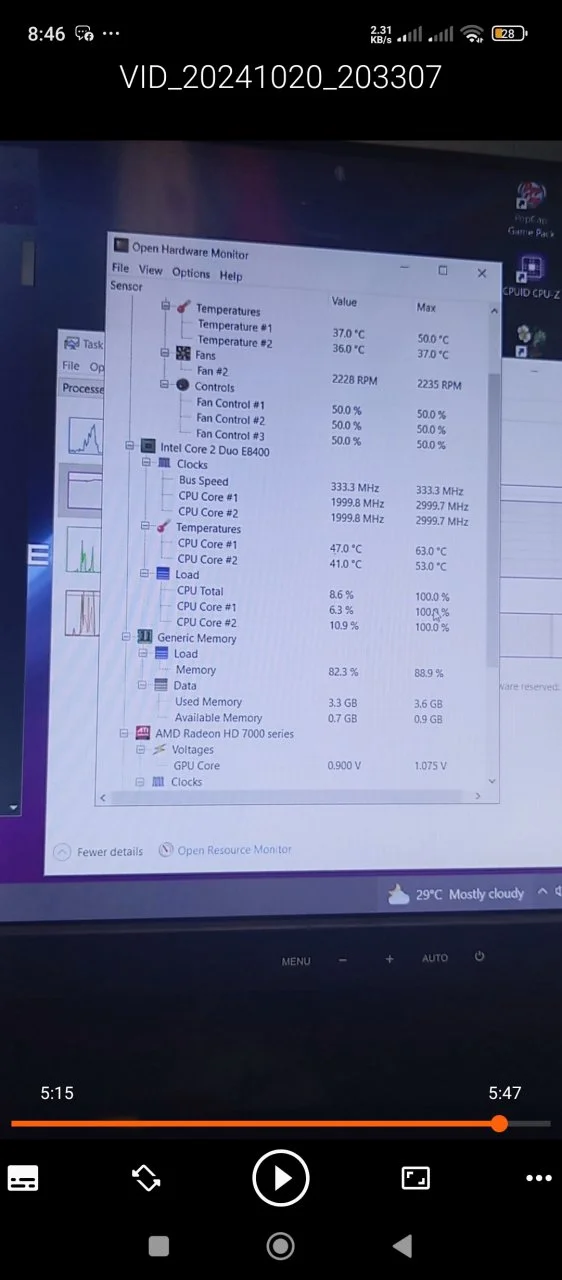

❓ Help Cpu 63c namamatay
Copper7
Forum Veteran
Normal lang ba ang temperature nya boss
1000006302-jpg.3172253
Solution
Yes normal lang 60c pababa ang hindi normal nasa 90+
kung namamatay meaning may faulty sa ram or mobo or cmos batt. Always do the basic troubleshooting step by step. First check mo processor if may thermal paste pa ba if wala na masyado linisin mo tapos palitan ng bago tapos if ganun pa din try mo linisin ram and palitan cmos battery. lastly if ganun pa din try mo palitan ng truerated power 80+ psu mo baka mumurahin gamit mo na psu nakaksira ng components sa cpu.
