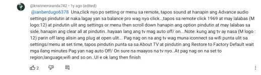

hello?same case din samin yan dati way back 2023 pa nasolve ko rin namn after 3months
yan sundan mo nalang,matek ayus nayan
