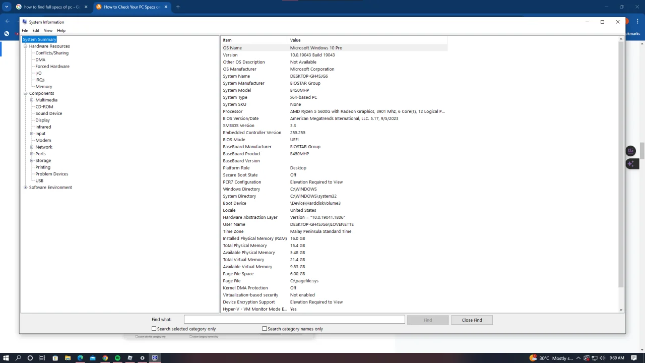

Balak ko po sanang mag dagdag ng GPU. Any recommendations, po? or any additional upgrade for smooth editing? TIA mga Master.
Tools for Video Editing Ginagamit ko.
1. Adobe
2. Capcut
3. Davinci
change CPU kung balak mo mag dagdag ng GPU. try to swap it with 5600 without G. that G variant is gonna bring your GPU performace down. or better get ryzen 5700x, just make sure you have a strong Nvidia GPU.
Change to SSD. using HDD in video editing nowadays should be considered îllégâl hahaha..
This is only optional get a 32GB RAM. i would have suggested to add 16GB but you have a crap motherboard so you cant add another 2x8GB
nakaSSD n nmn lods ako.
kakapalit ko lang ng motherboard e... if magpapalit me ng cpu into ryzen 5600 anong specific na gpu ang recommended for that cpu? na good for editing videos na.
And if i will change to ryzen 5700 ano recommended gpu ?
any GPU above RTX 3060. dependi sa kaya ng budget mo. nag palit ka pla nang motherboard nag change brand ka nlng sana sa intel. mas way better yung performance nila in editing.
anyway if you go ryzen 5 5600 get 32GB and if ryzen 7 5700x get 64GB.
this is requirements is according to Puget System.
maraming Salamat lods . i keep this in mind. Malaking tulong to
