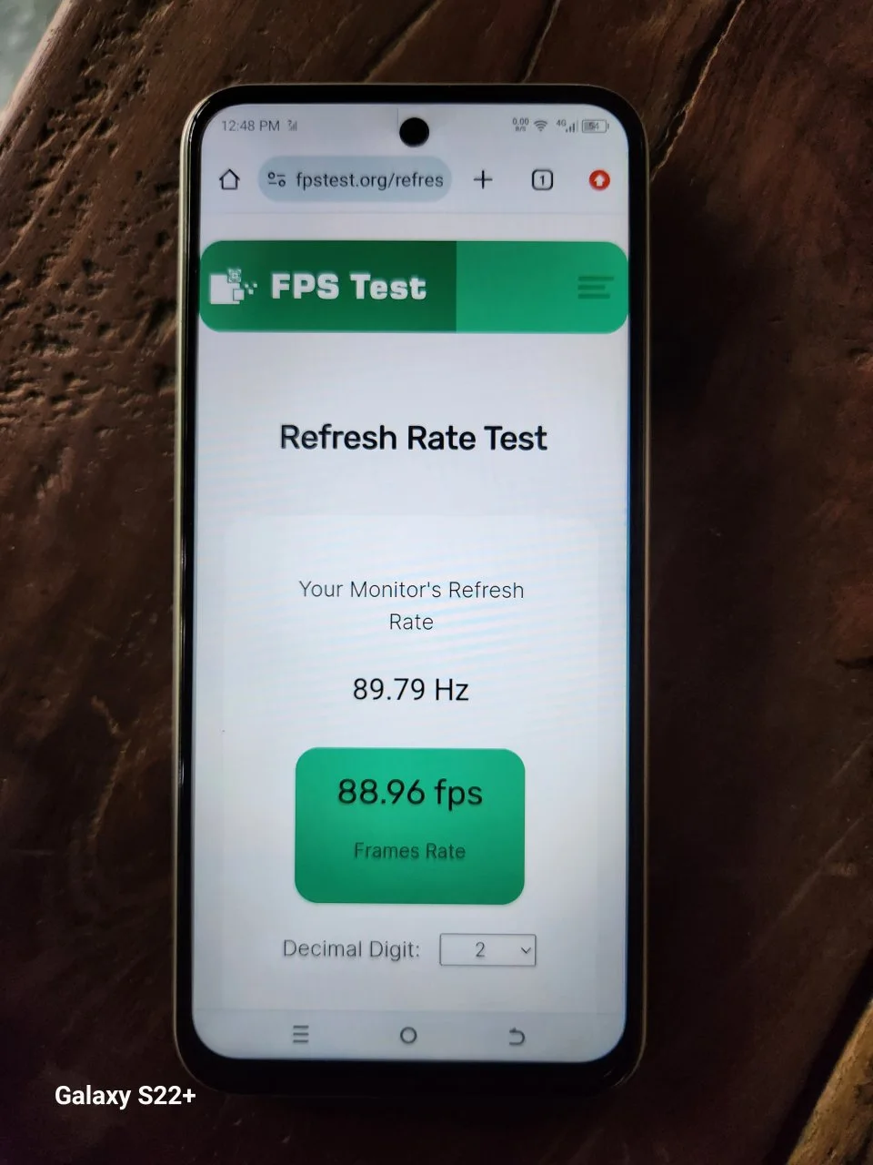

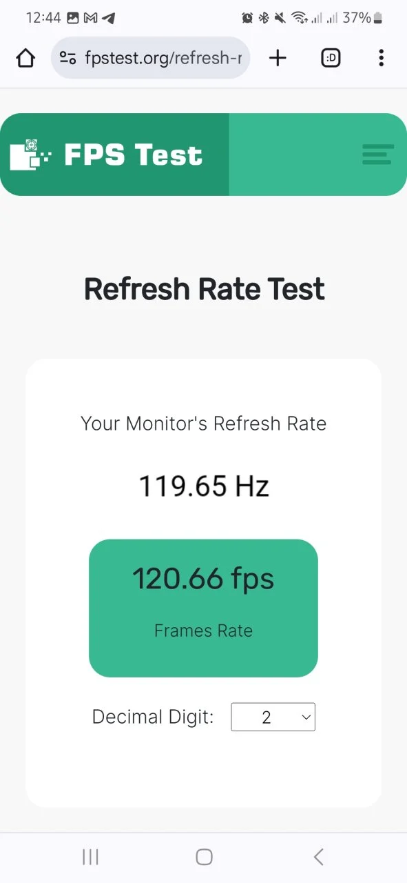

Tinest ko kung tunay na 120 hz nga , mukhang marketing strategy lang ni techno 😂90hz lang talaga refresh rate hahah 🤣 o baka mali lang ako 🤣🤣
Yung phone ko na isa ay samsung s22+

Yes, talagang naka 90hz siya sa ibang apps yung SPARK Go 1. Pero sa Settings lang gumagana yung 120hz, which is walang silbi ang 120hz sa ibang apps at games.
Dahil gawa ng OS mismo (currently HiOS 14.0.1 Go variant, December 20 2024 update), medyo conservative siya sa power. Also wala din siyang Smart Panel/Game Mode, dahil Go edition ito kaya hindi properly optimized sa refresh rate dyan.
Sa settings, meron lang option: Auto (120hz) at Standard (60hz).
No 90hz option, which is sayang. (Can be modified to 90hz via SetEdit)
So ang takeover ko dito sa SPARK Go 1, bogus etong 120hz pag oopen ng apps (sa Settings lang gumagana). Walang 90hz na option, pero specified sa Device Info HW. So I think 90hz lang itong SPARK Go 1.
Unless, Baka naman TECNO, baka ififix nila via OS updates. Huwag nalang asahan dyan kung ififx nila ang issue nyan from years e.

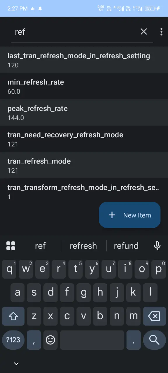

Additional tip:
Gagawa sana ako ng tips kung paano i-lock sa 90hz sa games. Still eto walang 90hz mode, then 60hz ang actual output.
Actual image:
With SetEdit: (Force 90hz mode)
Under System table, search the item "refresh". Set the value "90" all the way.

Additional tip:
Actual image:
View attachment 3570020View attachment 3570019

Actually Pwede mo sya Gawing up to 120hz by setting it to 121hz, since system doesn't recognize 121hz it will fall back to highest Refresh rate which is 120hz.
