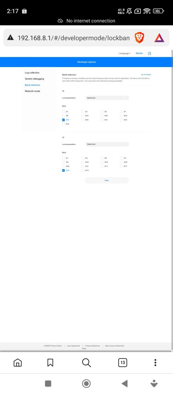

Sa may 5g area na dito pero 4g lang signal pag nagamit kayo ng h151-370 ni Dito ito yung internet trick para force 5G lang modem.
1. login to your modem default portal 192.168.8.1
2. login to developer mode to find it,
Go to advance/ system / system settings & look for developer option select it then may mag appear na login just login your password.
Other shortcut to login to developer mode go to You do not have permission to view the full content of this post. Log in or register now.
3. Select band selection
sa 4g go to band lock & just select the band na hindi makaka connect si dito like band 39 or band 20, don't select band 1, 28 & 40 kasi mag 4g sya
for 5g band lock just use band n78 for 5g connection. then save it, wait nyo mag restart connection.
Note: this process will only work if your area is supported ng Dito 5g & you can also use hybrid antenna to boost your signal
See the screenshot for reference
sana makatulong ty,......

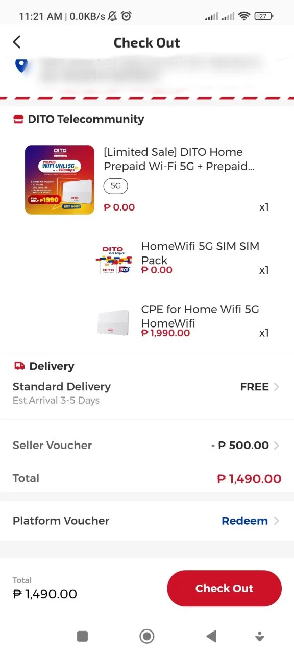

may stock na ulet paps sa dito app, may voucher pa less 500
