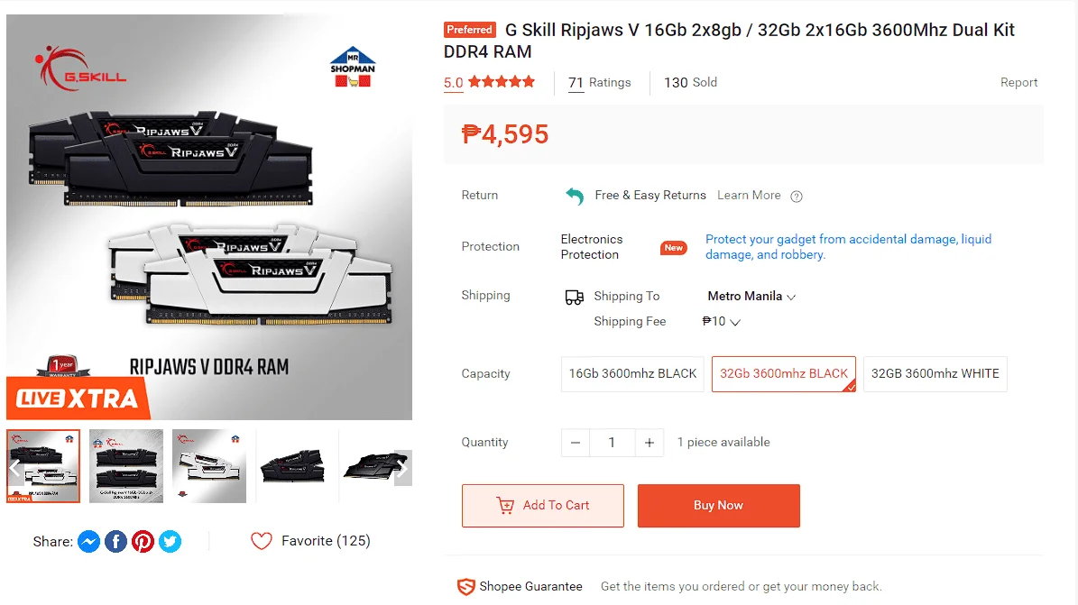

DDR4 RAM is way cheaper now. get a Gskill 2x16GB 3600mhz

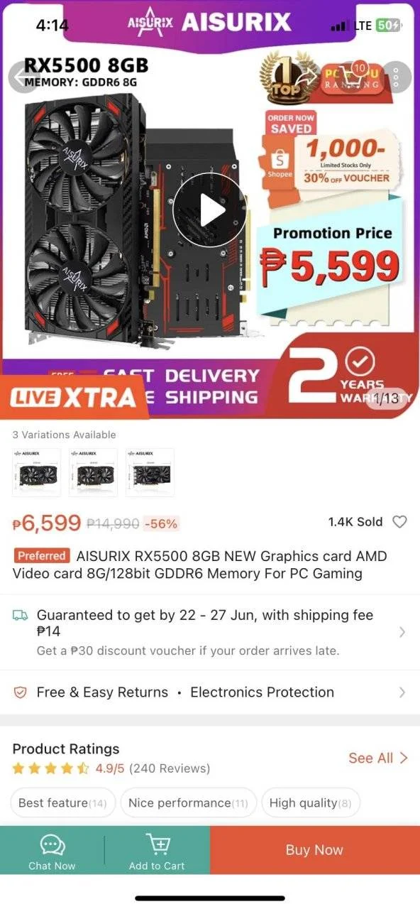

GPU = avoid Aisurix. get the sapphire or XFX brand. kung di kaya sa budget ang rx5500. downgrade ka sa rx580. hindi naman ganun ka laki ang difference nila sa performance.

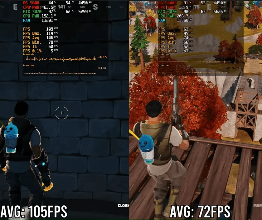

i wouldnt recommend that. specially kung into gaming ka. these are the following reasons.
1. 5600G is more expensive than 5600
2. 5600G only have 16MB L3 cache compare to 32MB L3 cache sa 5600
3. pag bibili kna ng GPU. malaki ang difference sa performance ng dalawang CPU. because of reason #2 - decrease in performance
4. 5600G is only PCIE 3.0 which makes your B550M motherboard a waste not using the 4.0 it also affects your SSD gen4 - again decrease in performance.
if I were you. I would rather buy the RX 580. get a single 8GB RAM stick and get a 500GB NVME. and suffer from it. ksi pag upgrade mo mas way better ang improvement. kaysa plano mong mag G variant.
a 1x8GB RAM with RX 580 in a 5600 is 100% way better than a 2x8GB RAM with 5600G.
anyway all of that still fits your 25K budget.

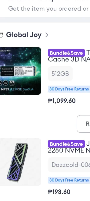

for nvme
merong mga good brand ng nvme na mura pero tago (well tinatago ng mga System integrator para di tumaas price)
1 tammuz GKV750 1tb 2.5k pci 4
(ito pinapapak ng mga SI kaya mahirap maka hanap ng in stock)
2 hikvision e2000 512gb pcie 3
(ito fave budget nvme ko since my libre syang good quality heatsink)
1999 sa ipason always in stock
ssd is ssd pci 3 or 4 di mo mapapansin pinagkaiba nila unless na lang na tatimigan mo ng stop watch pag ng launch ka ng program or laro para tigas PP

gpu aisurix rx5500 - 5600 vouchered

bad recommendations sa gpu, hindi reputable manufacturer ang aisurix puro refurbished kasi mga gpu dyan.
so?
refurbished or not yun yung kasya sa 25k
dalawa lang namn pupuntahan nyan either mg rx 580 sya na laspag na laspag na sa mining na mataas failure rate or mg aisurix sya na atleast my warranty na more than 1 week and newer supported model na hindi ginamit sa mining so higher reliability and driver support
unless payag sya mag 2nd hand ng cpu from 5600 to 3600 and walang case para maka bnew sya ng rx 6600 then maski anong hakbang nya ganun din hahantugan nya sapalaran
same if mag 2nd hand since anything below 6k or 7k 2nd hand in gpu is high chance my hidden agenda
even sa known 2nd hand seller like philkor eh naka kuha ako asus gtx 1660s na nadead within 2 weeks
so ganun din sapalaran masaklap pa dito 6 month lang warranty nila sa hindi high end na gpu
unless idodowngrade mo sya sa 5600g which i wont do since kasya na yung 25k with a gpu
like seriously upgrade later eh hindi ngyayari if starting point is super tight 9x out of 10 gaamitin nila yan hangang masira no upgrade since "goods pa naman" usually reason
now if budget is 30k then go pero as stated 25k so stay in 25k
