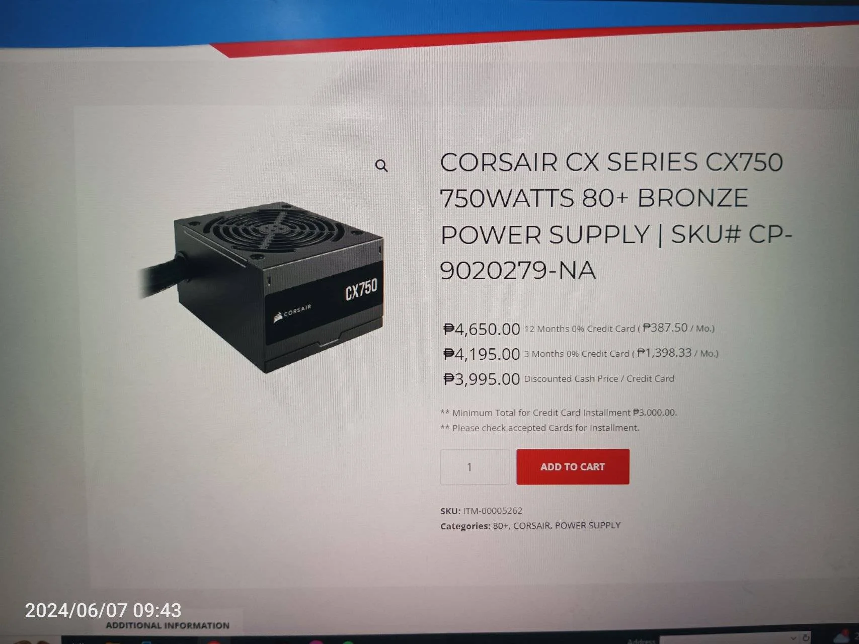

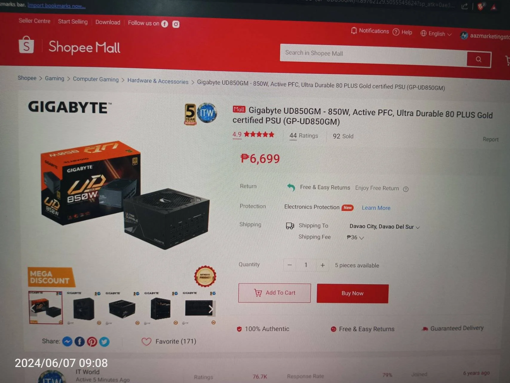

Eto paps? May brand ba na 5k below man lng po?
PSU lng palitan paps no after nun pwede iinstall? Wala namna kailangan baguhin pa sa motherboard?
