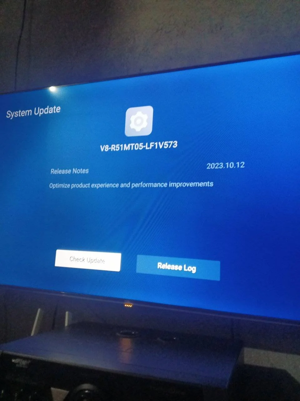

To check your TCL software version
Go to settings>system>about>product information(click it)
If your version starts with V8-R51MT05 pwede nyo i update manually sundin lang mga steps sa baba.

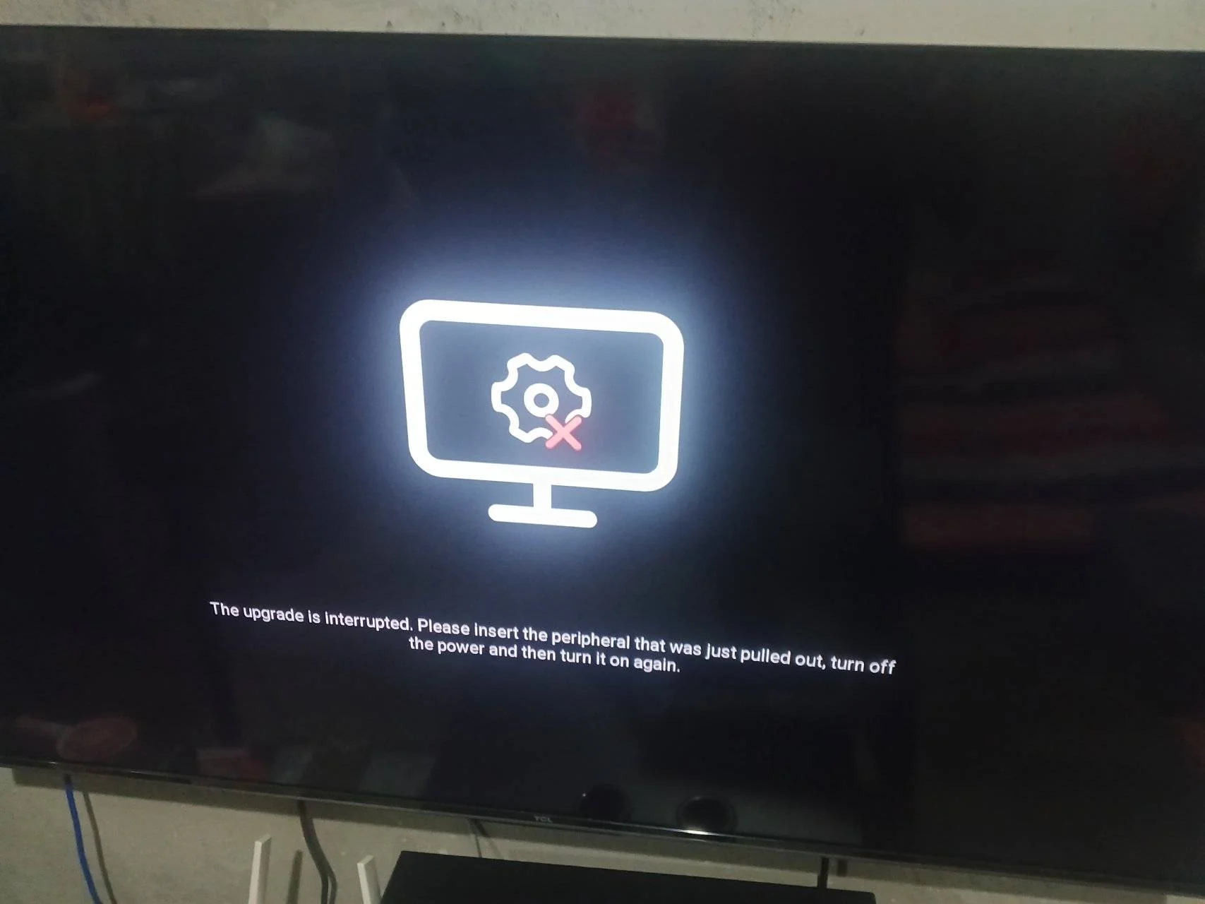

Method 3. Update TCL Android TV by Power Button
1. Format a USB Flash drive using FAT32.
2. Download the zip file containing the software for your TV to your computer.
3. Copy the software file to the root catalogue of the USB flash drive.
4. Unplug the power cord to your TV.
5. Insert the USB flash drive into the USB port on the back of the TV.
6. Press and hold the power button on the TV, not the remote.
7. While holding the button on the TV, plugin the power cord of the TV again.
8. When the software install message appears on the TV, release the power button.
9. Do not unplug the power cord during the software install. When the initial setup screen appears on the TV the software install is completed.
This method will not reset all your settings and installed apps.
