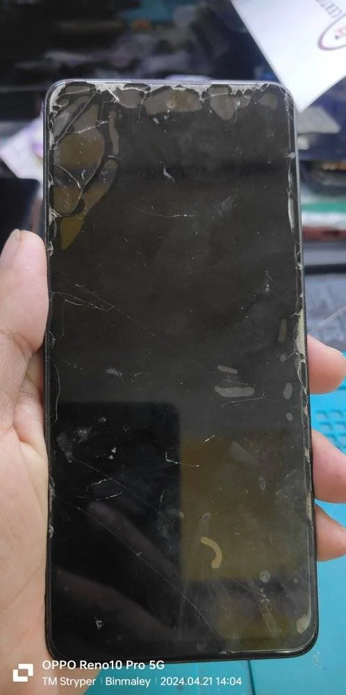

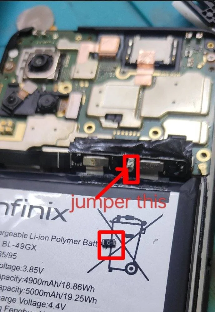

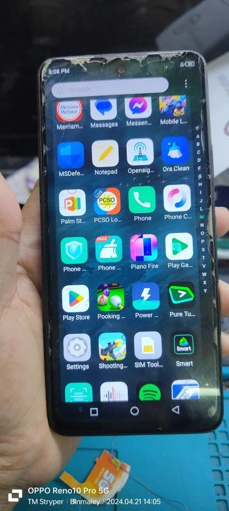

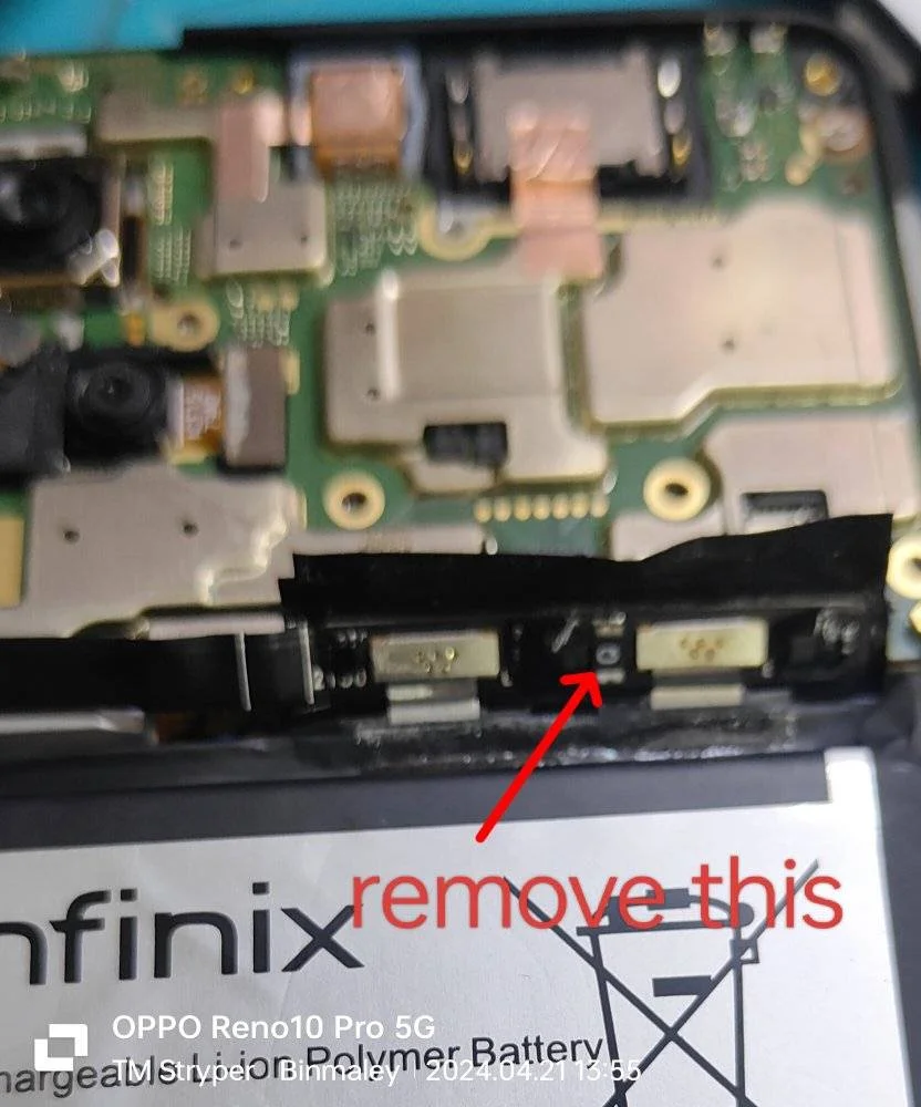

hot 11s auto restart
pag chinacharge di naman namamatay kaya ayon
dapat alisan ng koto
pagkatapos alisan ng koto
jumper natin

Paki explain sa amin boss kung anong reason bakit tinanggal yung SMB resistor at pinalitan ng jumper at yung purpose ng SMB resistor na tinanggal sa phone.
Smd resetable fuse or self-recovery fuse. This is used for battery protection. You can replace it with a new one or jumper if you have no available parts. This is a common fault in almost android batteries.
