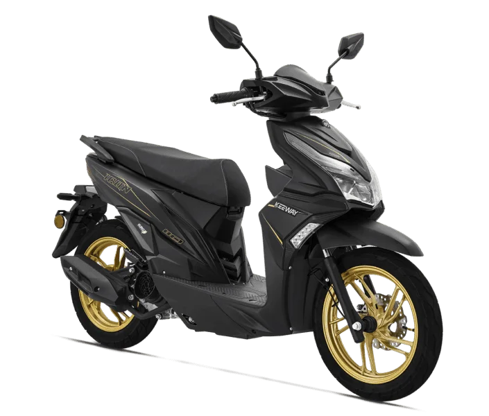

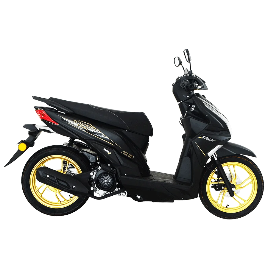

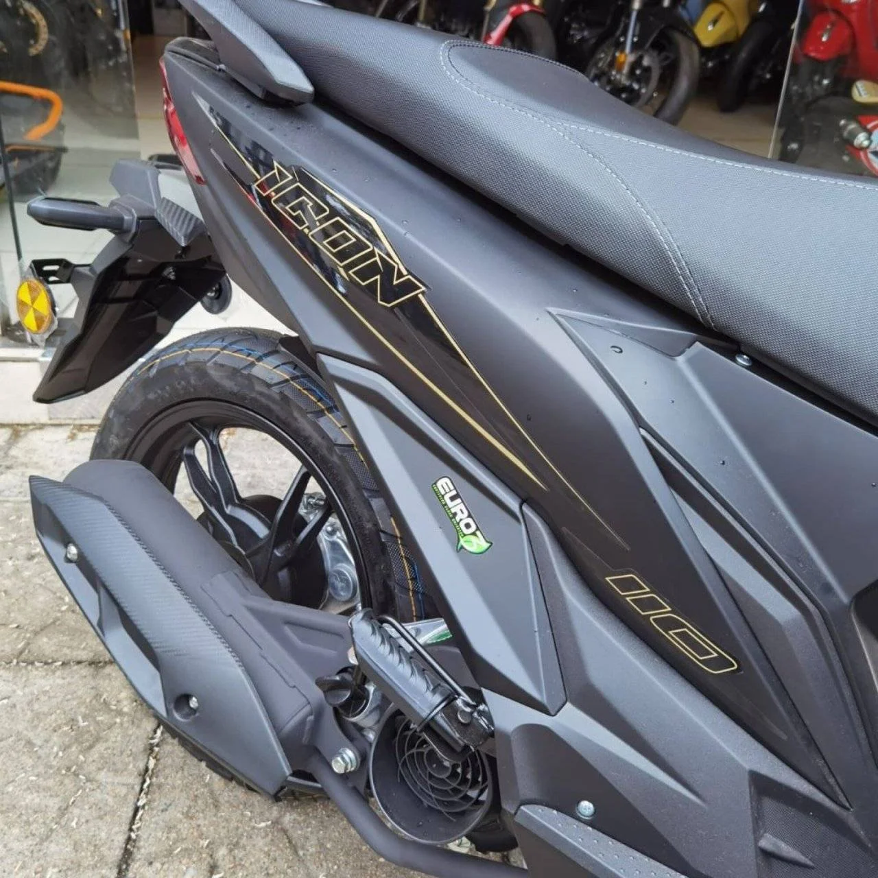

So I just got this KEEWAY ICON 110 SCOOTER as a newbie rider and kakakuha ko lang gusto ko marinig experiences, opinions, and tips! Nyo if meron kayong same model
as I've mentioned baguhan ako I would like to know about maintenence sa motor! Hindi lang puro gas n go ako HAHAHAHAHHAHAHA.
Btw installment ko lang to and temporary use cause im planning to buy another model in cash cause ayaw ko ng may binabayaran monthly if ever may recommendations kayo na model I would love to hear it!❤️❤️
