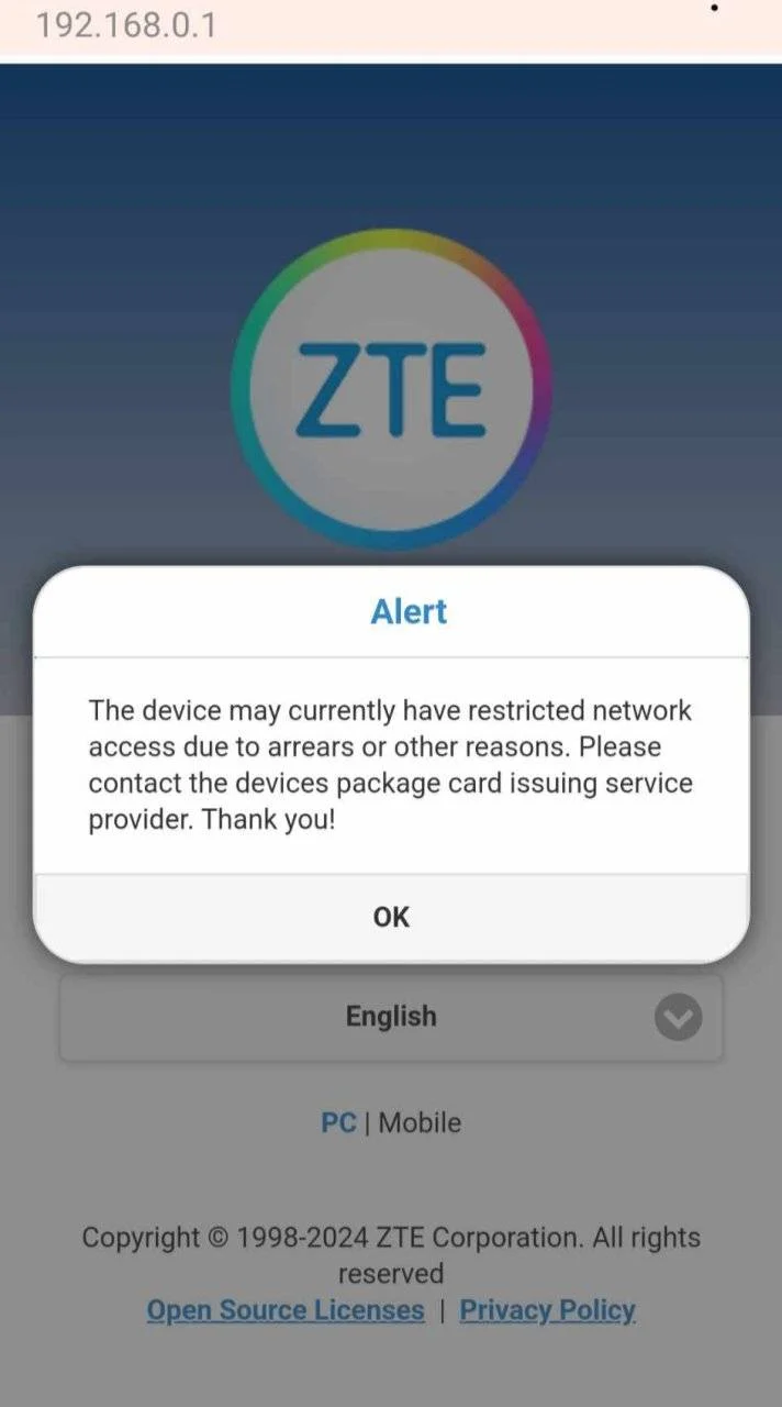

Ganyan rin akin, ts. Kung naupdate mo Mu5001 ng BD_FLYMODEMMU5001V1.0.0B02. Lalabas yan, kahit ireset mo yung unit waley parin. Maaccess mo ung youtube at google sa pc. Makakapag fb at youtube ka sa phone naman. The rest restricted na sites based sa experience ko. Either hintay tayo magrelease ng bagong update or sadyang may issue units natin? Hindi lang ako sigurado hehehe. Sa mga users nalang ng MU5001 wag muna magupdate baka mag ka ganyan unit nyo.

May update na ba? Hindi ko tuloy magamit yung ZTE MU5001 modem ko. May temporary fix ba sila?

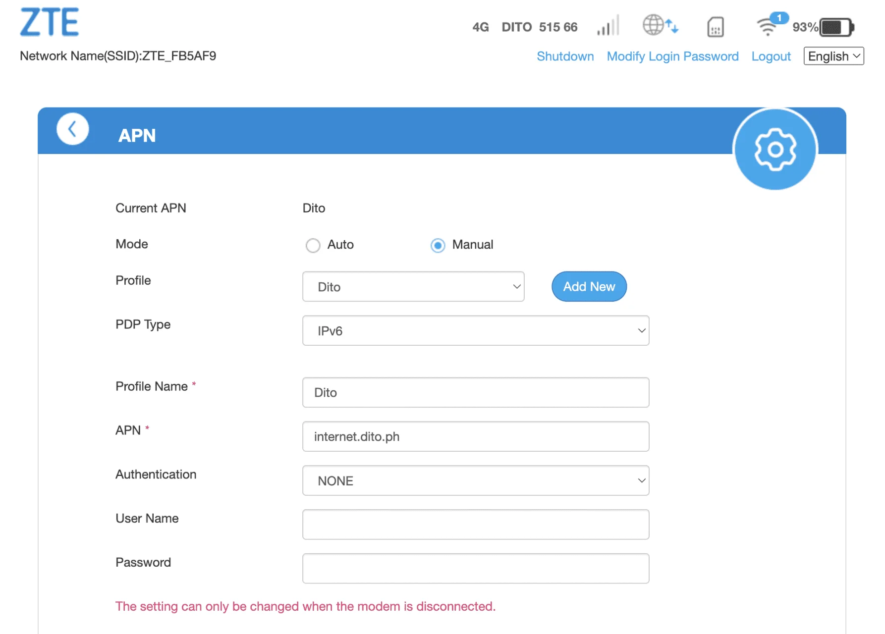

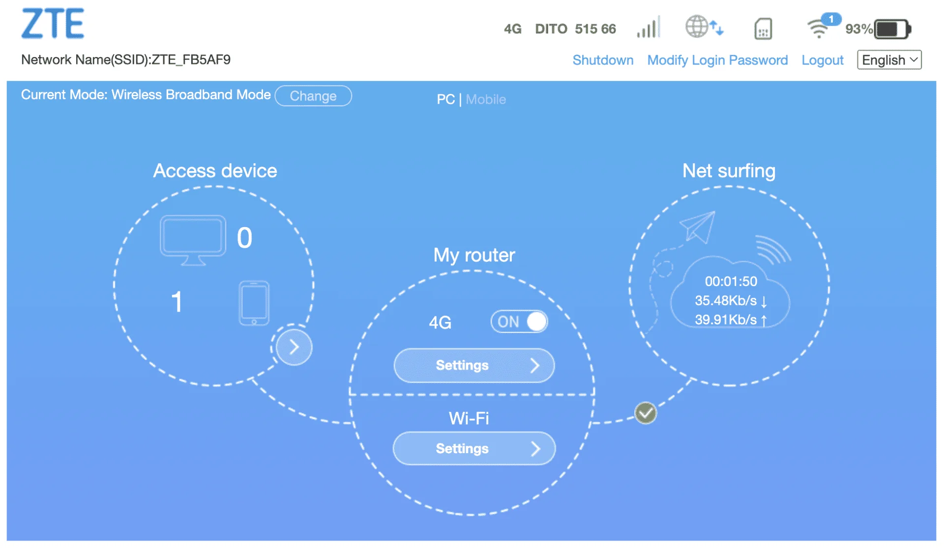

Found a temporary fix thanks to reddit! I haven't tried using other simcards besides DITO, though. Under APN settings, change the PDP type to 'IPv6' then reboot the modem. The 'restricted access' prompt should go away. You should be able to access websites with IPv6 addresses (ie. google, facebook, youtube, etc.). Other websites might not load. I also noticed that the modem cannot connect to the ZTE OTA server while on IPv6, so I guess we should revert back to IPv4 from time to time to check if there's a new firmware to fix this problem.

Found a temporary fix thanks to reddit! I haven't tried using other simcards besides DITO, though. Under APN settings, change the PDP type to 'IPv6' then reboot the modem. The 'restricted access' prompt should go away. You should be able to access websites with IPv6 addresses (ie. google, facebook, YøùTùbé, etc.). Other websites might not load. I also noticed that the modem cannot connect to the ZTE OTA server while on IPv6, so I guess we should revert back to IPv4 from time to time to check if there's a new firmware to fix this problem.

On top of this temporary fix, you can download Cloudflare's 1.1.1.1 free VPN app so you can access IPv4 websites such as reddit. So far, this combination of fixes can bring back most of the modem's functionality while awaiting for a firmware update.
