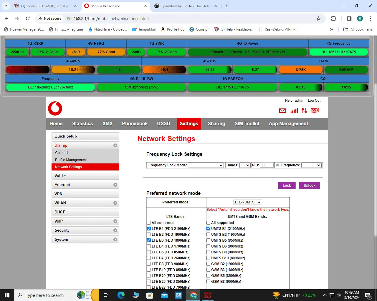

Note: looking at my B315s-936, the SINR strength is around 0 to -2db, is that okay?

TS bili ka nalang panel(directional) antenna mga 700php pataas lang naman. tapos doon ka mag scanning+bandlock at speedtest. pag may natipuhan ka doon ka mag cell lock

looking sa -2dbm SINR ay mukhang reflected ang signal na nasasagap ng modem antenna, posible maraming obstruction like buildings sa mismong tower at malamang naka auto band 28 yan modem based sa RSSI, kailangan mo FDD band 1 or TDD band 41 gamit ang bandlocking, kailangan mo ng external antenna at pwesto mo sa lugar kung saan mataas ang SINR ng modem kung sakaling walang line of sight sa tower
