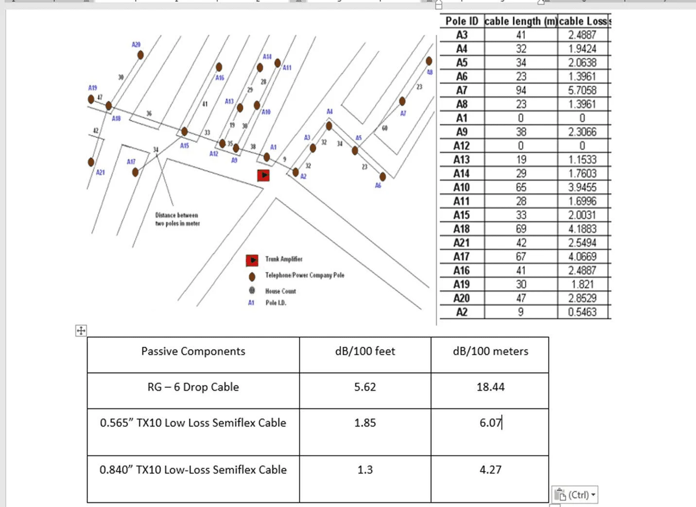

Eto po yung given strand map:
Nagets naman po namin yung cable loss. Ang gamit po namin is yung 6.07db/100meters.

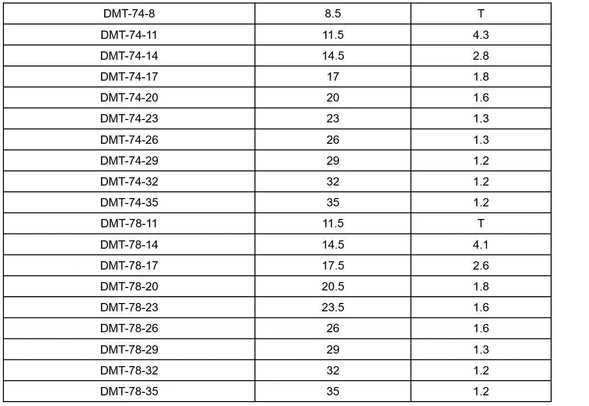

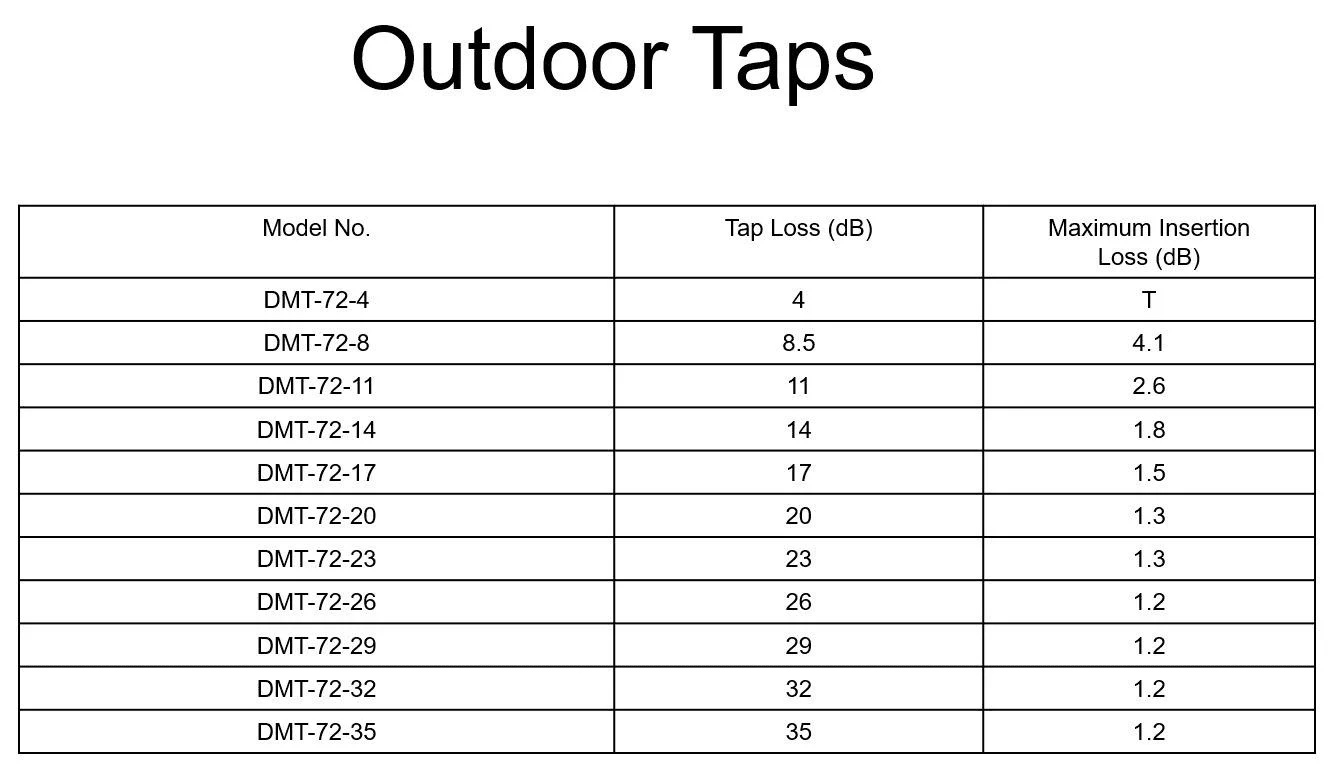

Eto naman po yung sa port and insertion loss:

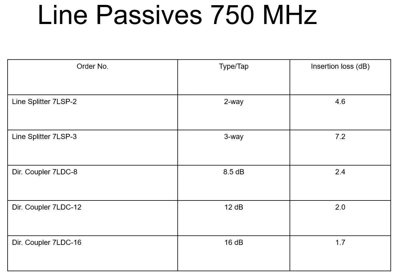

Eto naman po yung sa splitter and coupler.

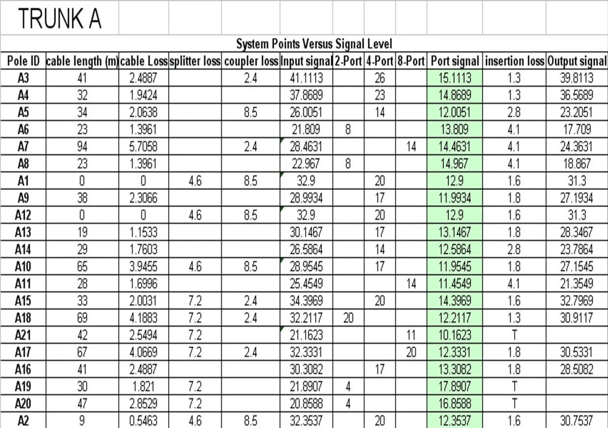

And eto po yung given table. Trunk A po is amplifier 1. Dapat daw po yung strand map namin ay may 6 amplifiers huhu. Kanya kanya din po kami ng strand map na gagamitin. May condition pa po na "The minimum received signal required for the input section is set to 15 dB"

Lagay ko na din po kung ano po yung naobserve namin:
Napansin po namin na yung port signal = input signal - port (either in 2, 4, or 8-port), then yung output signal = input signal - insertion loss. Yung may 4.6 splitter loss and coupler loss naman, napansin namin na yung input signal = 46 - cable loss - splitter loss - coupler loss. Ayun lang po, di din po namin alam kung tama po ba yung naobserve namin.
