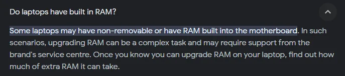

Your laptop most probably has onboard (soldered) 4GB RAM.
Did you check if the old 4GB stick is working/good condition? It's possible that the old 4GB RAM stick is faulty or defective hence only 4GB is shown initially and what was being detected by the laptop was the onboard RAM. So when you added the new 8GB RAM stick, it detects 12GB RAM (4 onboard + 8 new stick) total.
Test the old 4GB RAM stick on a different but compatible laptop. Check if it gets detected or not when installed. Or put it back again on your laptop and make sure to properly seat/install it then check if it will be detected and it must show 8GB (4 onboard + 4 old stick).

Yan din sabe ko baka may built in ram na. Pero as per ts said po, hindi daw nag bboot yung laptop ng walang ram. Meaning walang soldered ram yung laptop nya.
