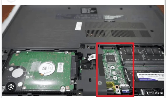

planning to upgrade my laptop kasi matagal na yung boot time and pag open ng applications, currently naka hdd and meron din syang extra slot for M.2 NVME any suggestion mga boss kung palit na lang hdd to ssd or add na lang ako ng M.2 sa extra slot?

check your laptop model specifications first before buying or adding on pcie slot. 2 types of m.2 >> nvme or ngff, then speed supported para iwas aberya.
