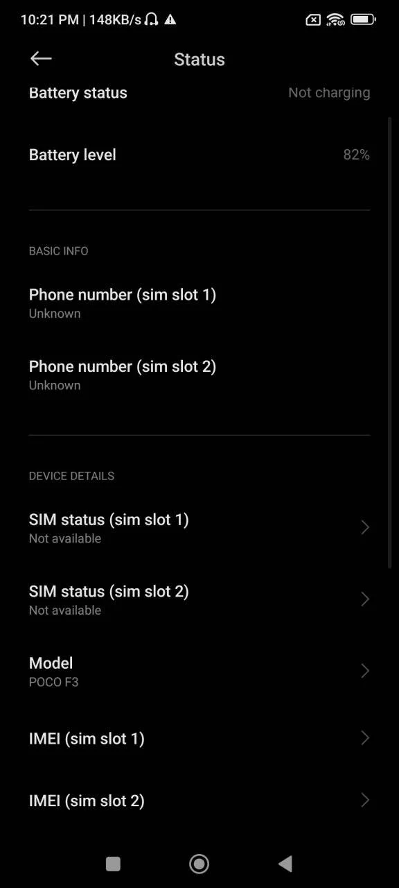

Help Po may Iba paraan na d pumunta pa sa repair shop wla Po IMEI wla signal Po sana may ka help po

Paano ka ba nagflash ng rom? Via recovery or pc? Kung via recovery mababa lng ang chance na madamage mo yung nvram nya,pag via pc posible madamage pag mali ang process mo. Before doing anything kc sa phone mo, make sure to make a backup especially ung security backup nya. Jan kc nakasalalay yung baseband.
