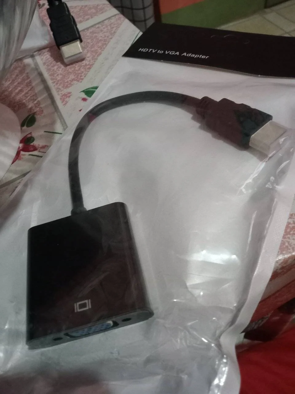

Kapag ba bumili Ako Ng VGA TO HDMI FEMALE ADAPTOR IMG_20240208_183902.webp Meron bang audio.
Bumili Kasi Ako Ng HDMI TO VGA FEMALE ADAPTOR ang problem Yung sa Chromecast naka built in Pala Yung CABLE Ng HDMI. Kaya di ko maisalpak Yung HDMI CABLE

if HDMI to VGA gumagana audio dyan.. pero make sure na bibilhin mo may nakaindicate na may Audio port. meron kasi ako nabili walang audio port na ganyan.
bout naman sa VGA to HDMI di pa ako nakakabili ng ganyan.

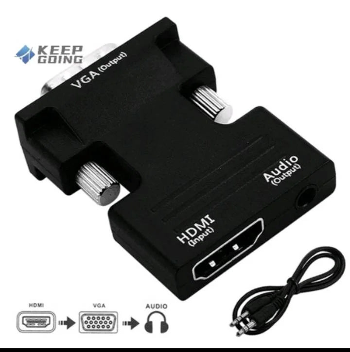

TS, pwede mong gamitin yung HDMI to VGA adaptor mo (yung unang picture). Sa HDMI input nung adaptor mo direktang iko-connect si Chromecast, VGA out sa monitor at yung Audio out naman nung adaptor ay mas magandang sa external sound system mo na lang i-connect. Check mo na lang yung audio output nung adaptor, kung stereo ba or surround sound channels (5 +1); diyan mo iba-base yung gagamitin mong audio cables.
